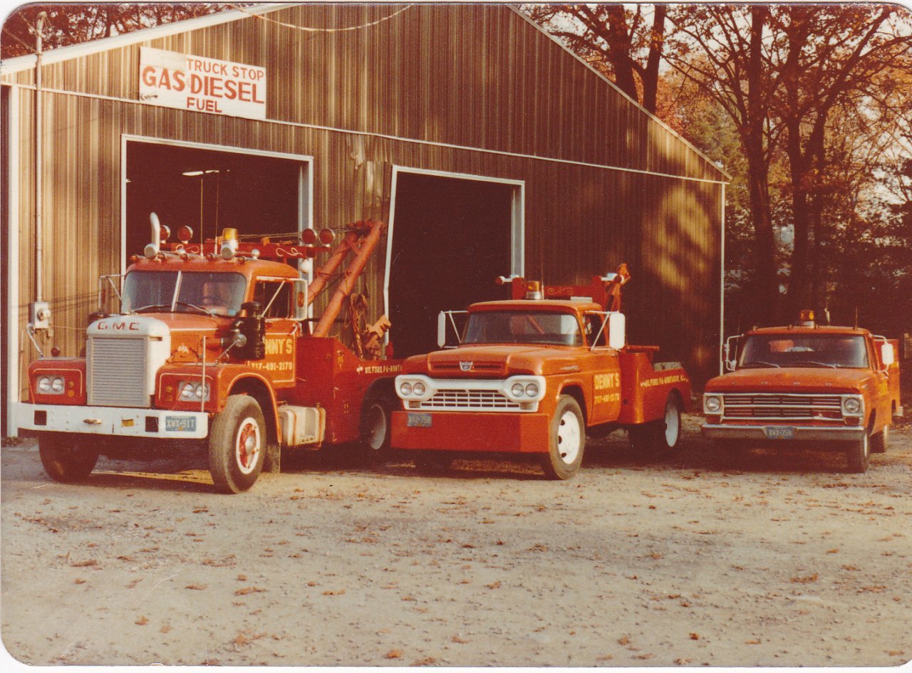

    My dad owned one of those full service truck stops, if you could call it that! We had two diesel and two gas pumps, a nice three bay truck shop and two wreckers. That is where I learned how to drive and backup, talk about a different time, who today would let a kid blindside their rig into a spot or for that matter let a fuel jockey inside their truck at all. We had four spots just east of our fuel pump, had to pull past them and blindside in, otherwise had to pull out onto Route 209 and back into the other side of the lot to park if those were full. Talk about the liability my dad took having me do this stuff, then again I also worked the road and cleared wrecks with him at the same age.
    Drivers would pull up to our pump, I would fuel, vacuum the rug, clean the windows and park the rig for them while they walked two doors down to the Village Diner for a meal. When they came back they would pay for the fuel, tip me (a 9 or 10 year old kid) and head out. If they needed any repairs dad would hook them up while they played the pinball machine in the back or took a nap on one of our beds in the bunk room. Good old days.

    Now that's a great post.

    I could also add that because most truckers in that time had little or nothing to do in that sleeper then sleep they had more contact with other drivers. Anybody that remembers trucking in the 50s and 60s remember this. I can not count the times I remember a bunch of drivers sitting around tables (not drivers counters like today) and sit and spend hours solving all the countrys problems and giving the waitress (good natured) hell. It was such a different time. The day they destroyed the old Goldmine Truck Stop I was actually watching some of it. Lots of memories were being put in those trash containers.
