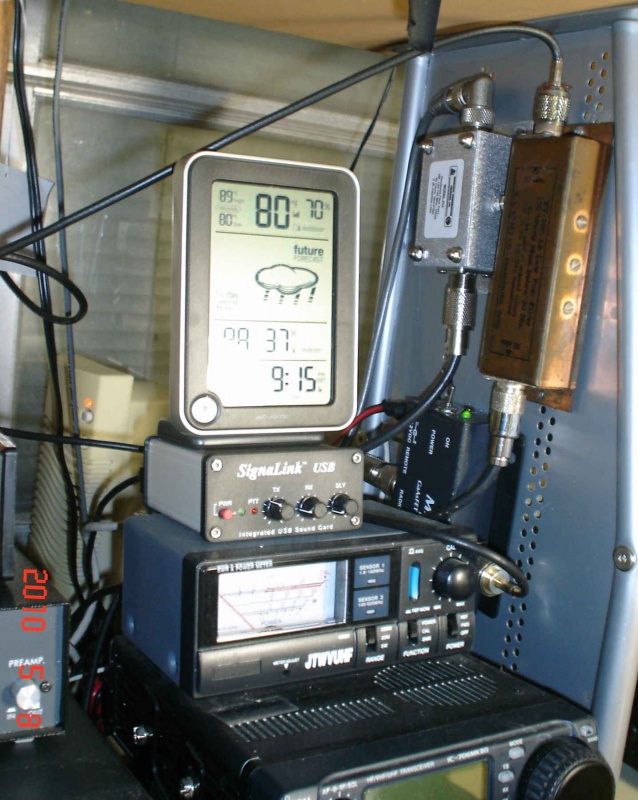

    ONLY IF THE RADIO IS DIRTY .....
    Explane what a "TRUE " SWR ( VSWR ) meter is ?????
    The SWR meter is so simple a cave man could build it ... The idea goes back into the 1920's ....
    I use a meter that goes from 1.3 Mhz to 450 Mhz and is as good as my Bird#43 it is on top of my 706 .... YET I also have some $20 CB meters that will do the same thing on the 11 or 10 meter bands.

  5. WA4GCH
    WA4GCH Road Train Member
    3,324
    577
    Aug 12, 2009
    Seminole Florida
    Receivers in most CB's are just fine ..that said EVERYONE ( ME INC ) wants to hear just a bit father ....
    Now there are PREAMPS of many types but at 27 Mhz the background noise
    is high enough that they do little good unless the signal is just above the noise and your receiver is a bit punny ....
    http://www.copper.com/cart/product_info.php?products_id=305
    Now I have had several of these and if you need gain they will do it BUT again the noise is high enough that It is not likely it will solve your problem.
    Here is my station with preamps from 160 - 2 meters if I need them . The mireage preamp for 2 meters is the black box to the right of the signalink digital adapter.
