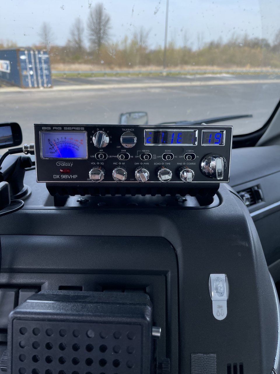

    I personally have a Galaxy DX98VHP that I am running in my 2021 Volvo. On the dash there’s an area that dips down and has a rubber mat to stop things from sliding around. If you pull that piece of dash trim up, directly underneath there is where the fuse panel is and where the power straight from the battery runs up to. I mounted my DX98VHP right there and used 8 gauge leads for the power and ground, using the included 50amp inline fuse that was included with the radio. I’m using the new Stryker SR-A10 antenna and love this setup!
