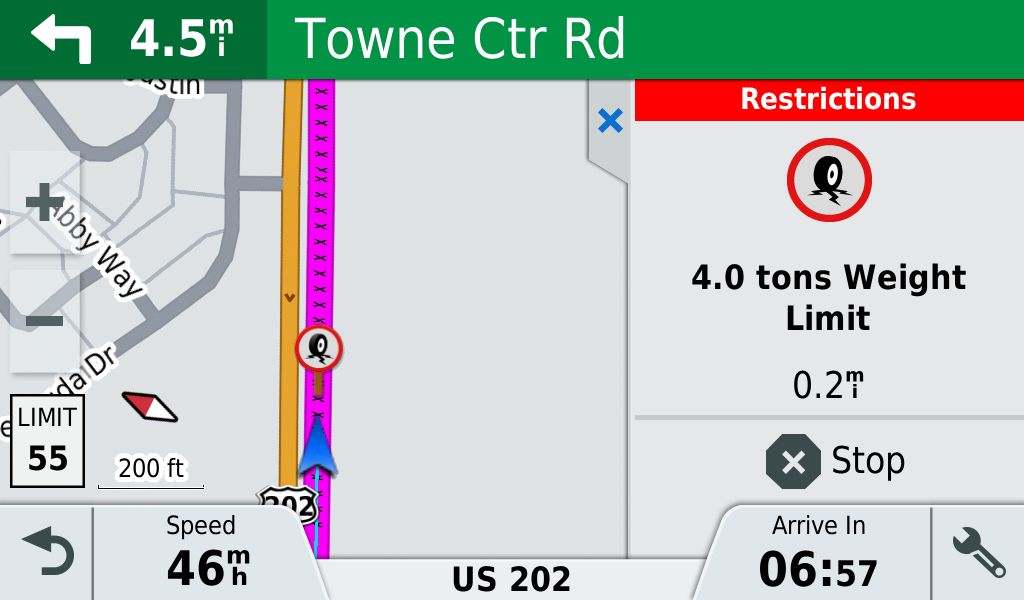

  5. WadeH
    WadeH Bobtail Member
    43
    14
    Apr 1, 2019
    I *think* what is causing this Garmin false-report problem is the "crossroads." I reviewed this section of roadway travel from my dashcam and noticed that as I drove along the highway (US Route 202 in NJ), there were signs posted at the crossroads indicating a 4-ton weight restriction for the crossroads. Somehow Garmin is picking up these weight restrictions for the crossroads and attributing that same restriction to the main highway.
    I noticed this same phenomenon in NYC when I was northbound on I95, after crossing the GW bridge, my Garmin falsely reports red-light cameras. The Garmin must be picking up the camera from the intersection on the bridge above I95 and then falsely reporting it to me as being on my lane of travel.
    Does anyone here know how Garmin manages to grab the good information from a crossroad and then falsely attribute it to the road being traveled?
