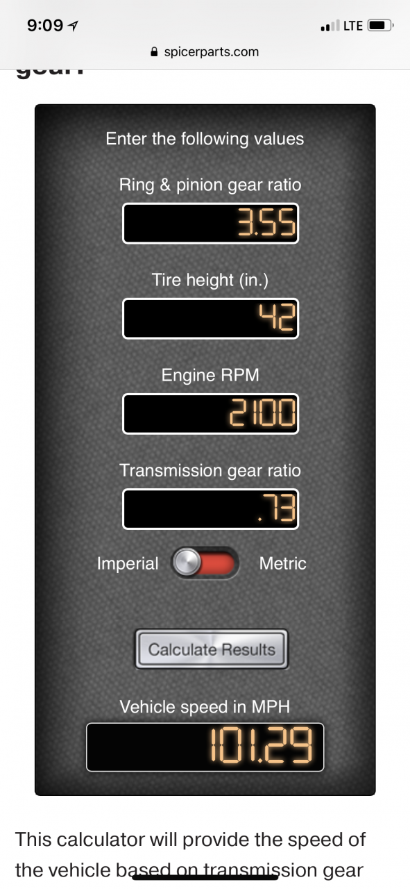

  10. Hammer166
    7,629
    27,943
    Aug 18, 2007
    ~8600+' and loving it!
