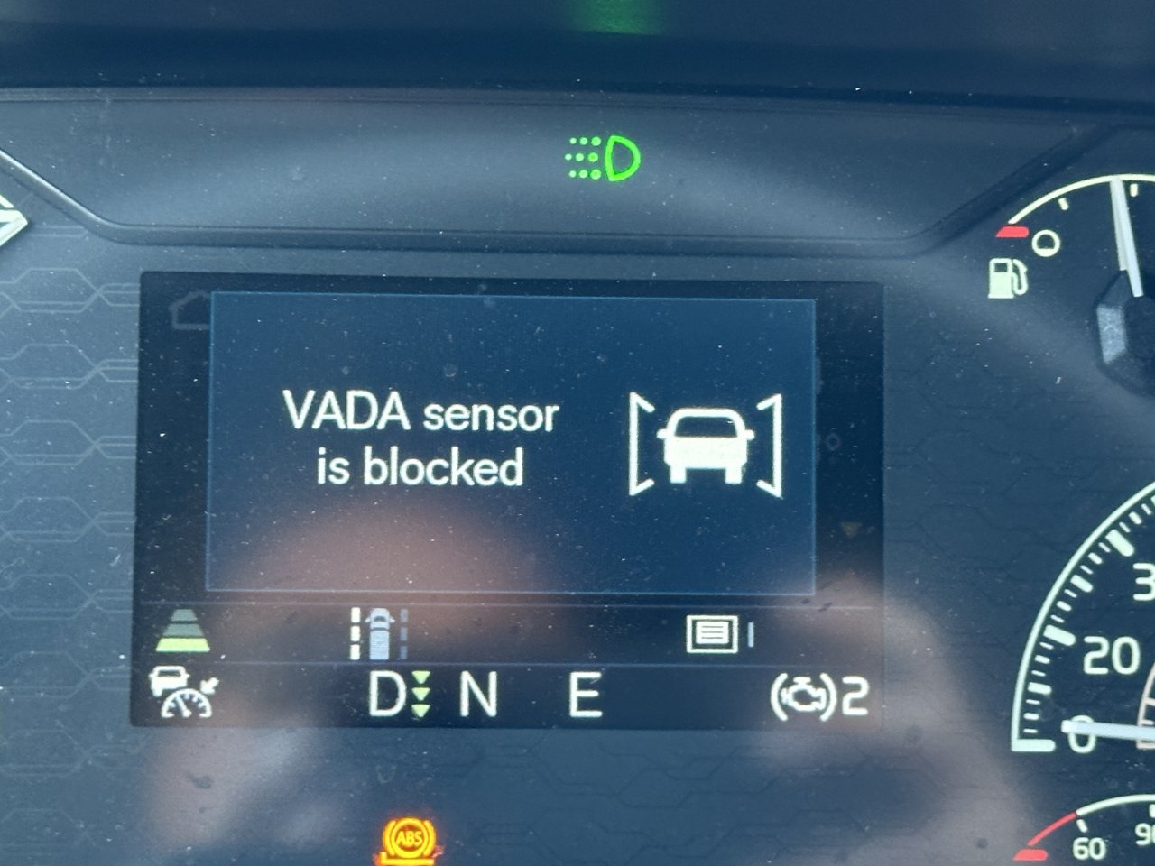

  8. Weiboy718
    Weiboy718 Bobtail Member
    47
    34
    Jan 25, 2017
    Nevermind about disabling the VADA sensor.
    I used some foil tape and wrapped the radar sensor with 3-4 layers of the tape and now my sensor is officially blocked, no check lights whatsoever only a pop up message saying the VADA sensor is blocked. Cruise control works like a traditional truck would, but the adaptive does not work which is fine with me. The beeping literally drove me nuts! I’m happy with the results with the simple mod.

  10. KB3MMX
    KB3MMX Road Train Member
    3,076
    2,596
    Dec 29, 2014
    Orrstown, PA
    Simple fix if you are the truck owner.
    Use configuration changes to the vada and use configuration 7 if I remember right.... It's the least sensitive settings.
    Unless you're within 18' of a vehicle it won't beep anymore
