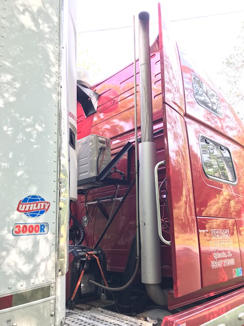

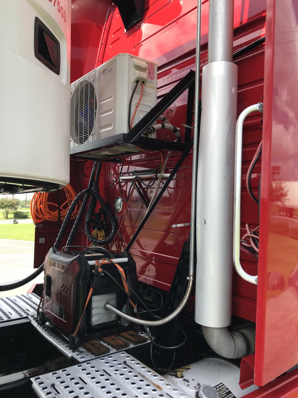

    My current generator (Predator 3500) has a stub coming off the muffler that has the same O.D. as 3/4" electrical conduit. This will fit Espar heater stainless flex pipe that can be purchased at Thermo King or Carrier (not cheap but lasts a long time). This flex pipe is solid with no joints like other pipe.
    I then have a length of 3/4" conduit that is hose clamped to my exhaust stack. It barely sticks above the cab. (Does not go up and down with the cab)
    I use Permatex Ultra Copper to seal the connections with 3/4" stainless hose clamps holding the joints together.
    All that being said, I just bought a new Honda EG2800i. If the exhaust doesn't have the right size outlet, I'll end up welding a short piece of 3/4" conduit to the muffler so I can use my same setup.

    Very nice set up. Is that an air hose on the fairing? Or extension cord?

    Air hose, yep. Extension cord for shore power runs along the bottom side of the cab, secured with blobs of polyurethane and plugged into the shore power outlet.

    I remember your posts on the mini split. Still the best do it yourself APU I’ve seen yet.

    That is a nice setup.
    On my truck the exhaust everything is connected right with the cab that rides up and down so I can't set it up that way.
