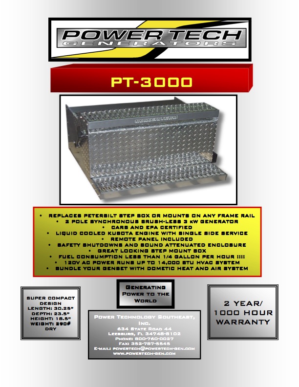

    Ok, I emailed the Powertech rep to ask if the 3kw model in the last link above is 120/240 split phase and to also get the engine rpm since I am interested in this model since it may drop between the frame rails.
    It is 2600rpm and 120/240 spit on request by the way.
    Anyway, he emailed me a product they make that I couldn't find on their website which has the same machine built into a Peterbuilt type step.
    I'll upload the photo he sent in case anyone is interested:
    No affiliation, I just have one of their generators and am passing this along.
