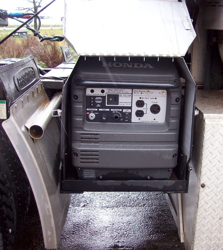

    I run a Honda EU3000is, Dometic Commercial 10,500BTU rooftop ac, interior heater, battery charger, etc etc etc. Saved an absolute fortune thus far.
    I installed the AC myself, made the mount for the Honda etc. It's on industrial slides, so just slides out for service etc.
    Installed a wireless remote to start and stop it from inside the truck.
    Runs the AC or heat @10-12hrs on 2 to 2.5gallons of gas. The 3000is is perfectly capable of running a rooftop AC unit BTW, as evidenced by my own setup.
