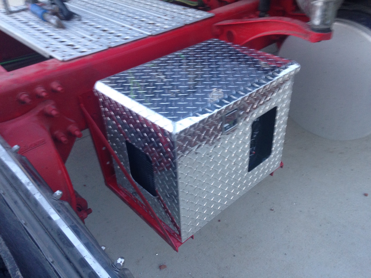

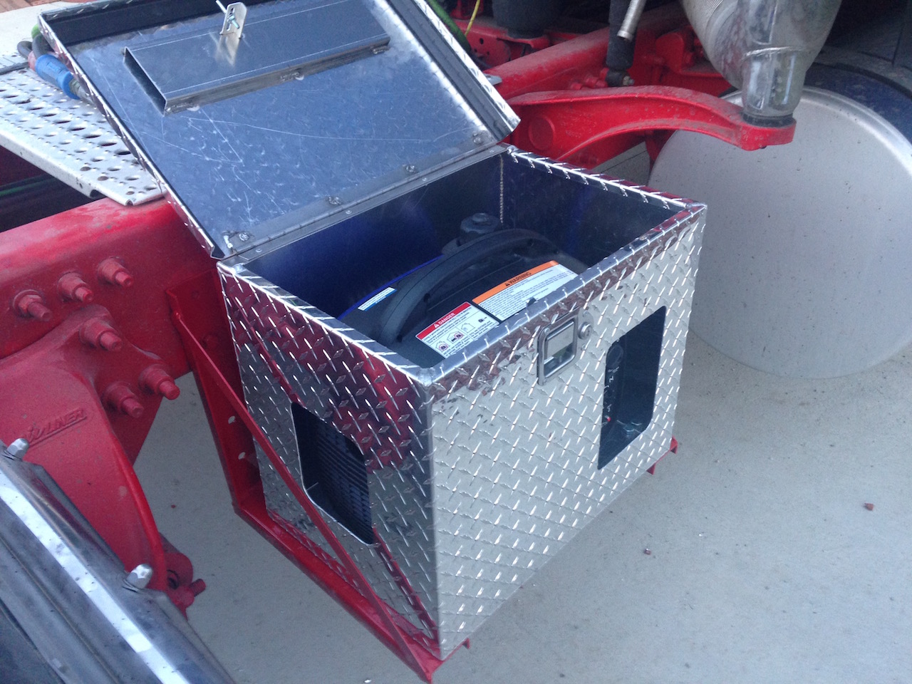

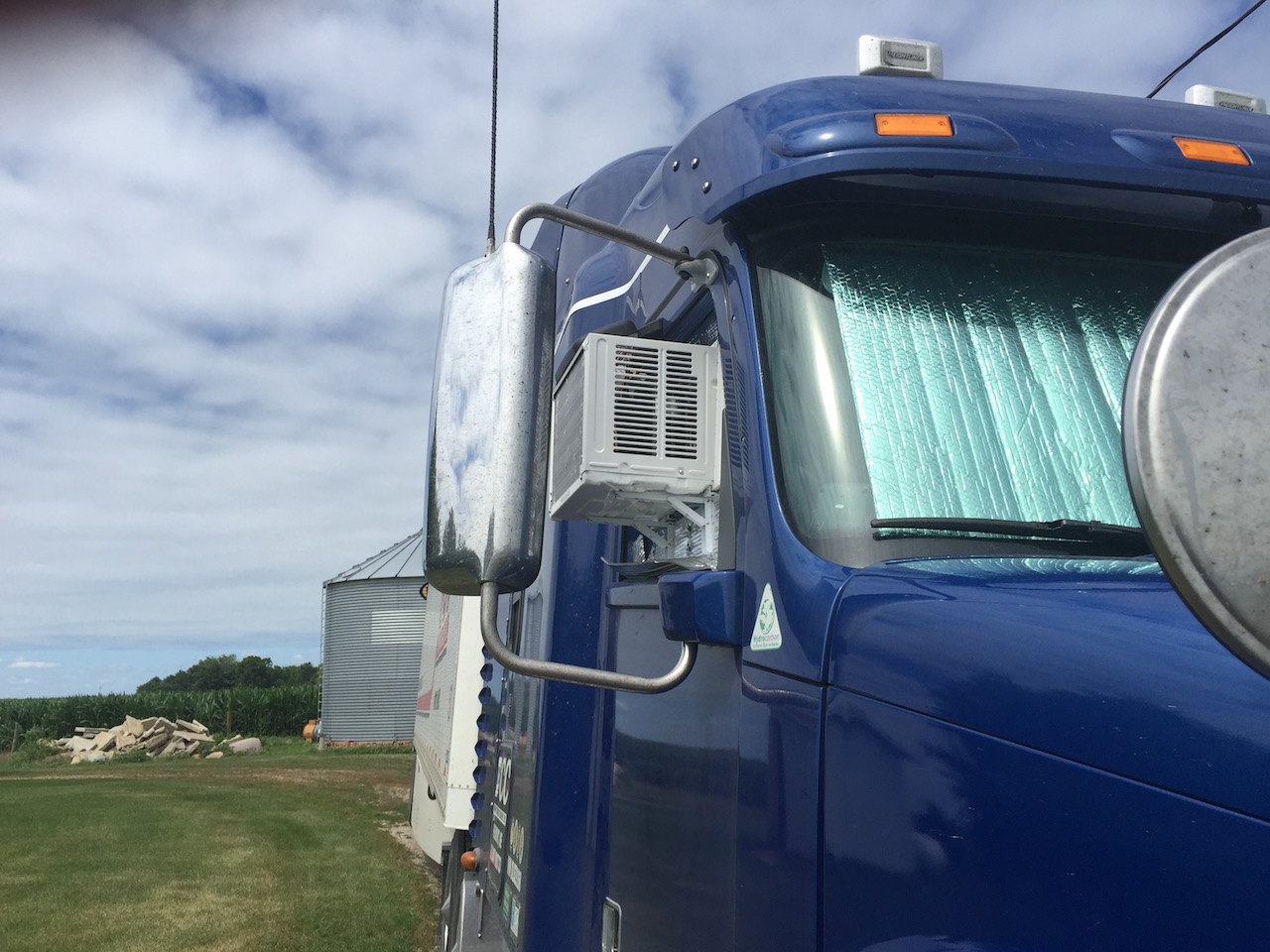

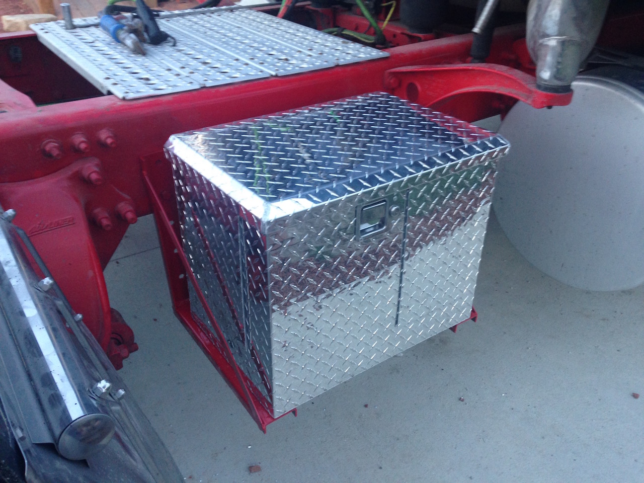

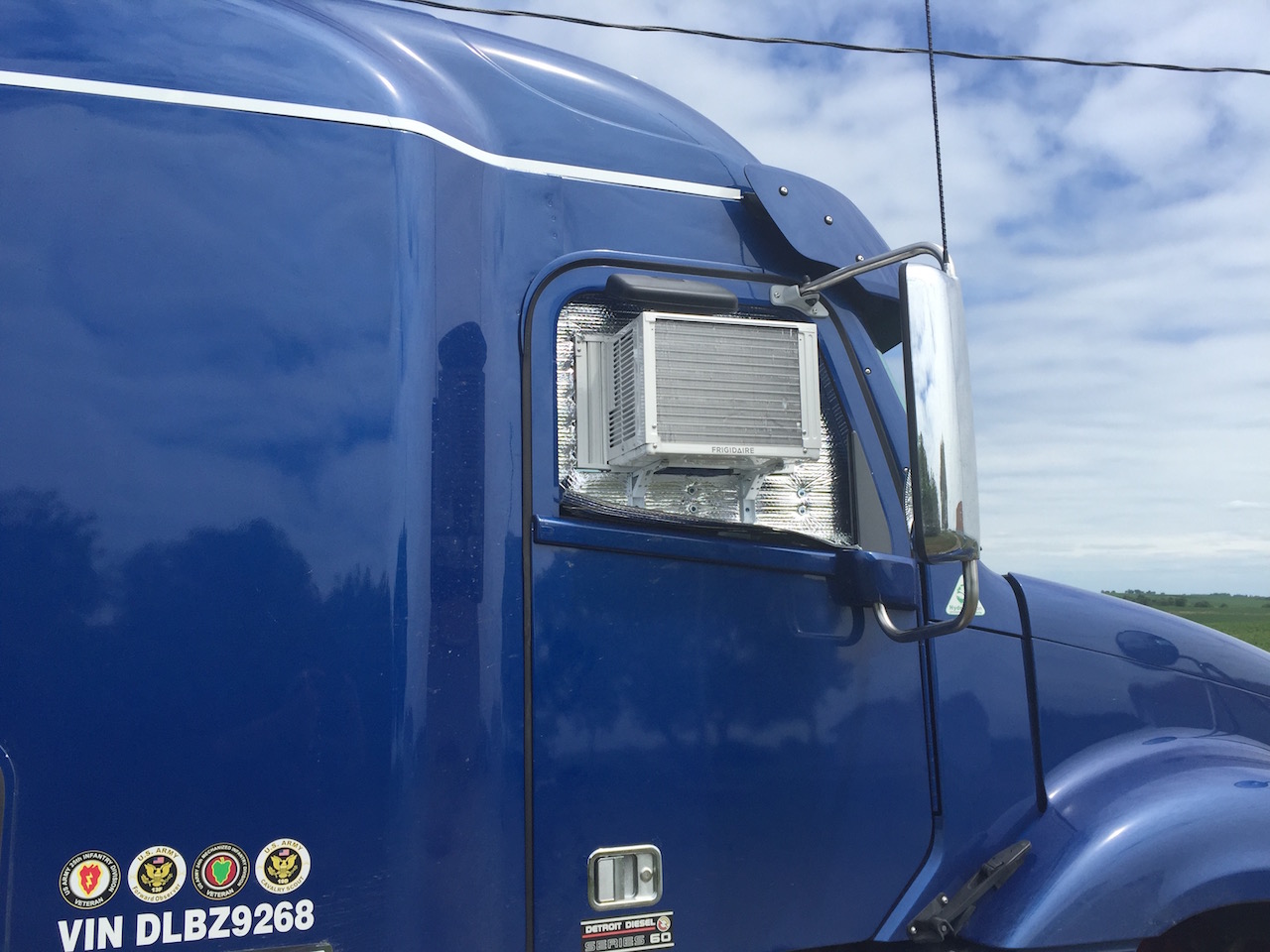

    My little Yamaha EF2000 and a window A/C works great for my needs. The Yamaha doesn't even have to operate at full RPM to cover the load. About 8 hrs on a gallon of gas. I made a custom frame for the window out of plywood and covered with reflective insulation that fits nice and snug and I use a $139 window A/C I got at Lowes. Not much more than $1000 for everything and no more than 100 lb total. Quieter than other trucks around me that use APU's. Their APU's sound almost like refer units in comparison to my little Yamaha EF2000.
    Generator rides in box and when panels removed from sides, runs right in the box out of weather and secure.

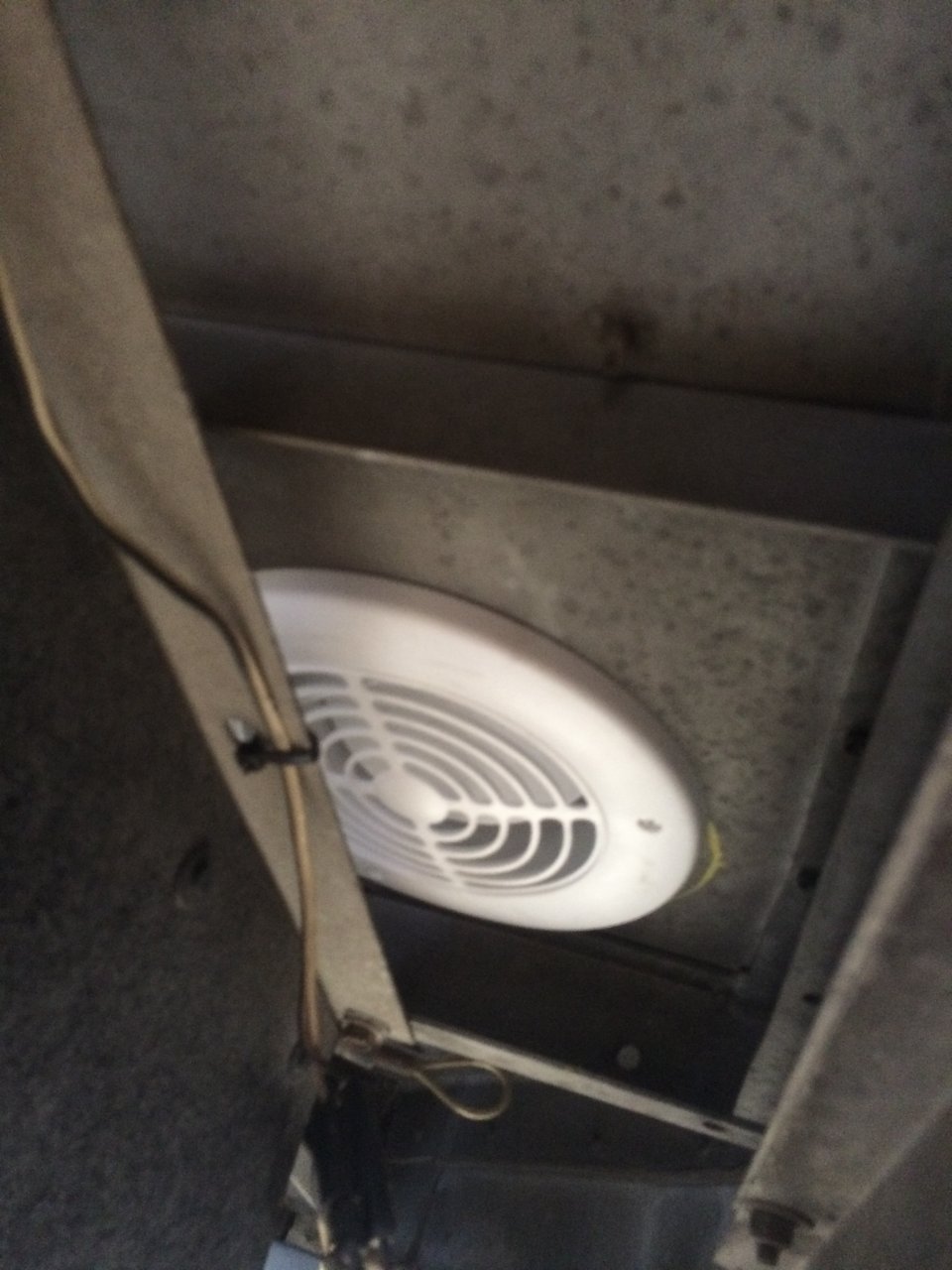

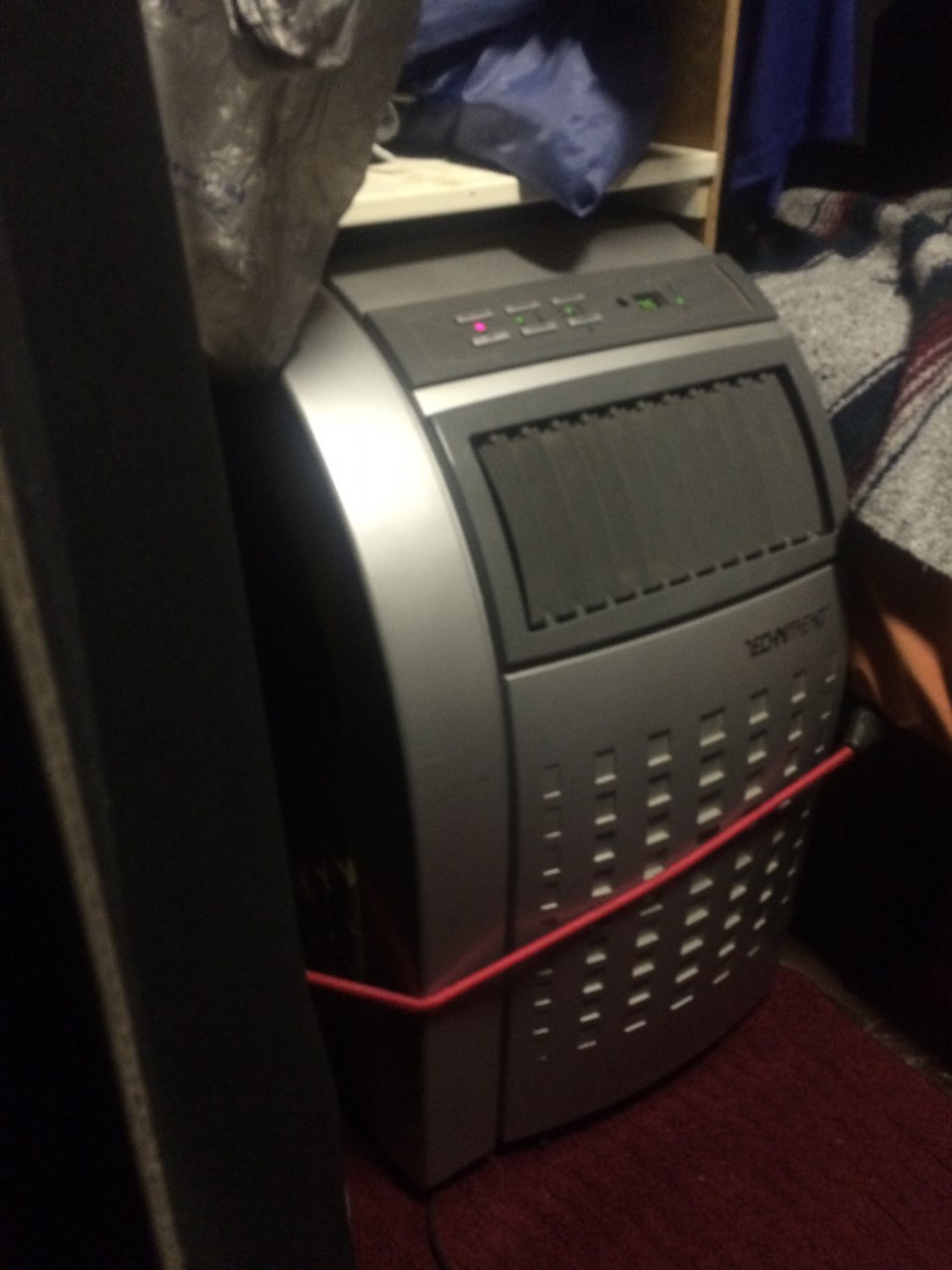

    I use the same champion unit with a room air conditioner. Just cut 2 6' holes in the floor of the sleeper. image.jpg image.jpg Get a dual hose unit if you can aford it. Mine is a single and struggles a little bit over 100deg. I already had it for 6 years now.
    4rdtruck, HopeOverMope, Hurst and 3 others Thank this.
