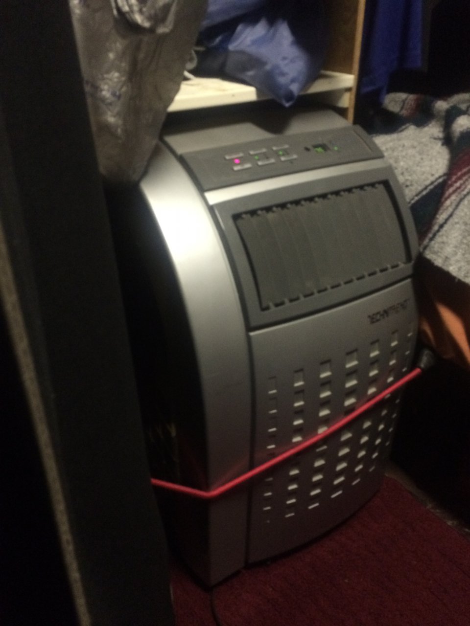

    IMG_1093.JPG IMG_1155.JPG IMG_1792.PNG Make sure you get a double hose one if you get one. No outside unit. Self contained. 2 holes in the sleeper floor.
    Terry270 Thanks this.
