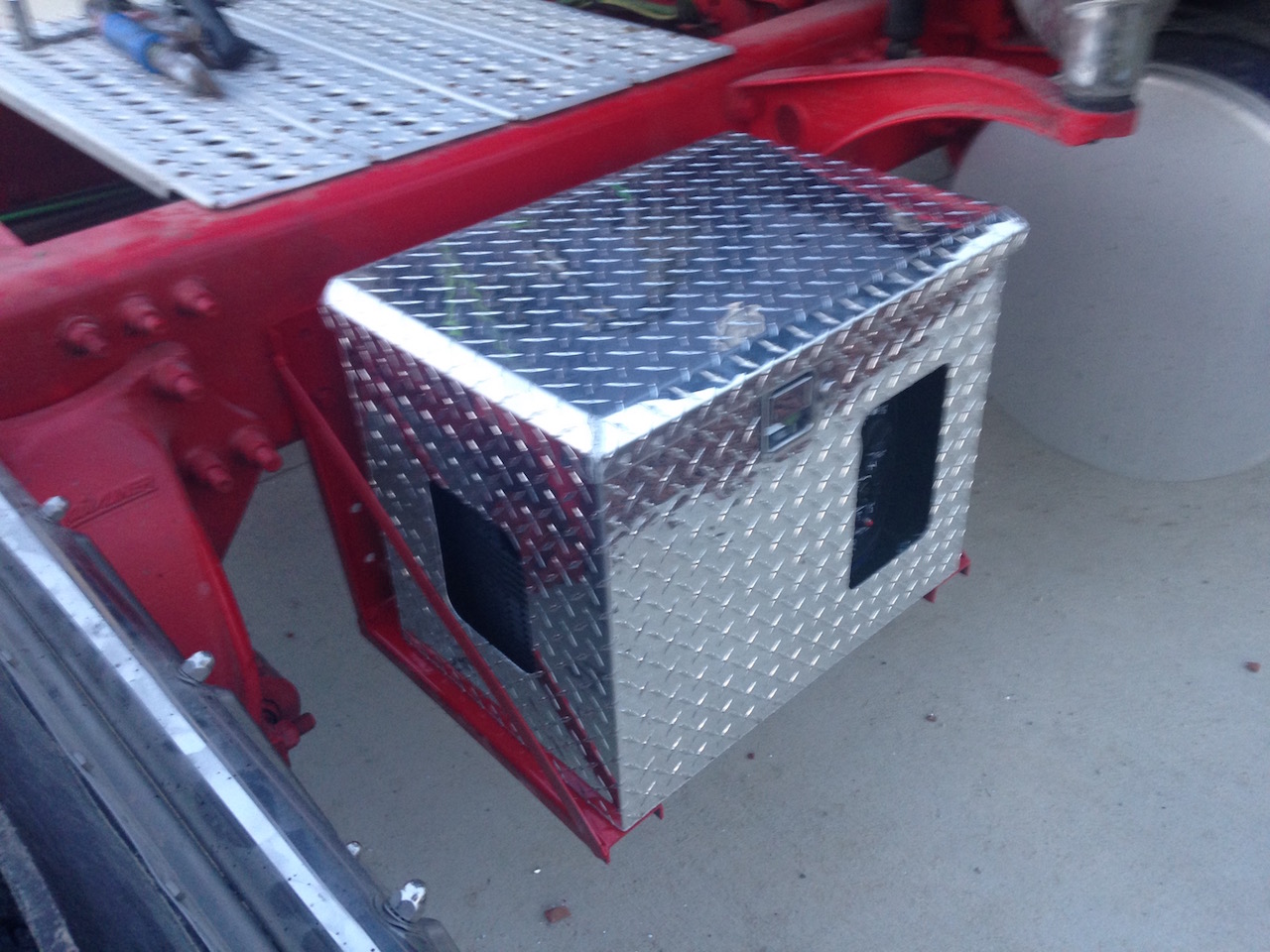

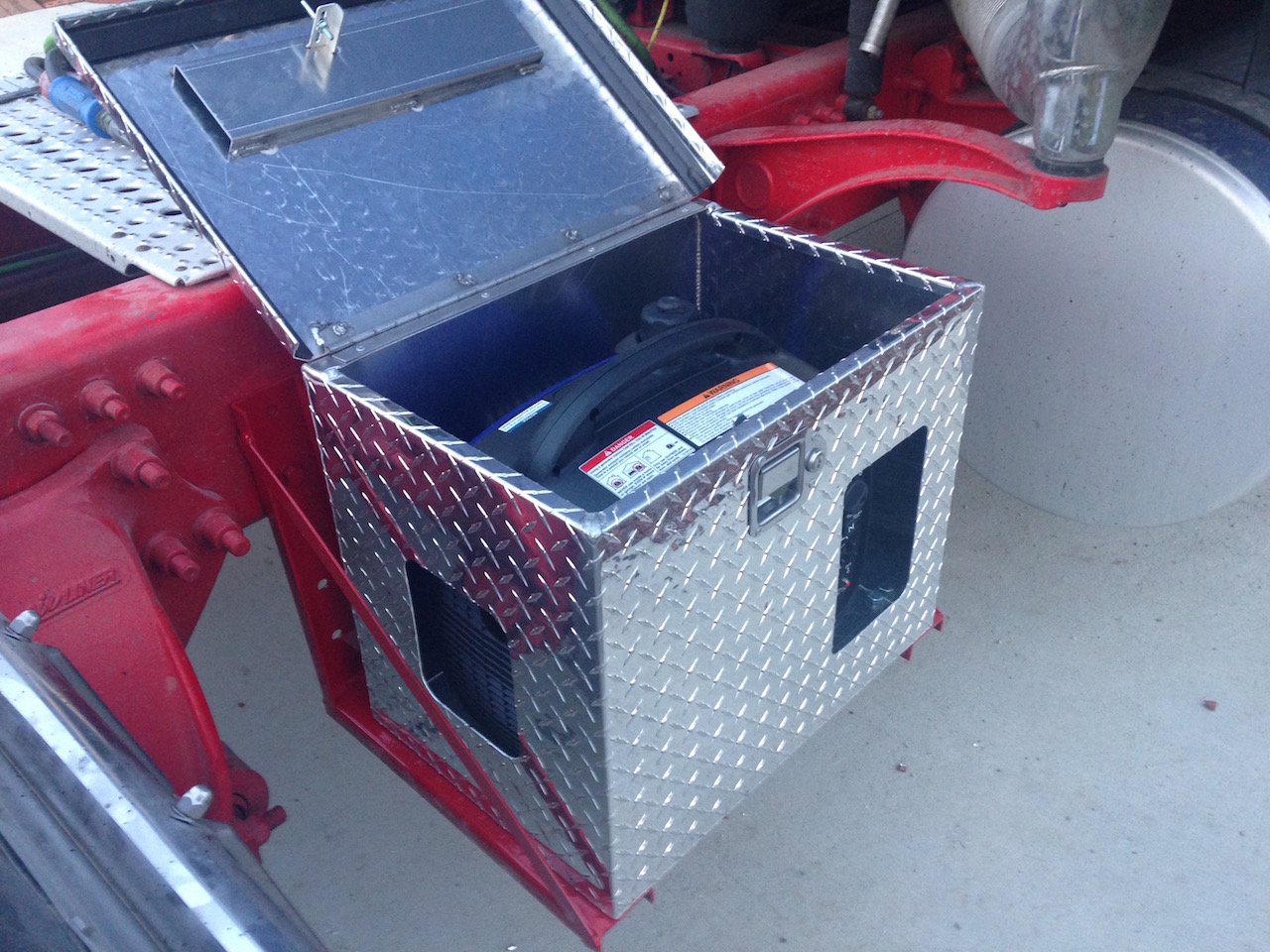

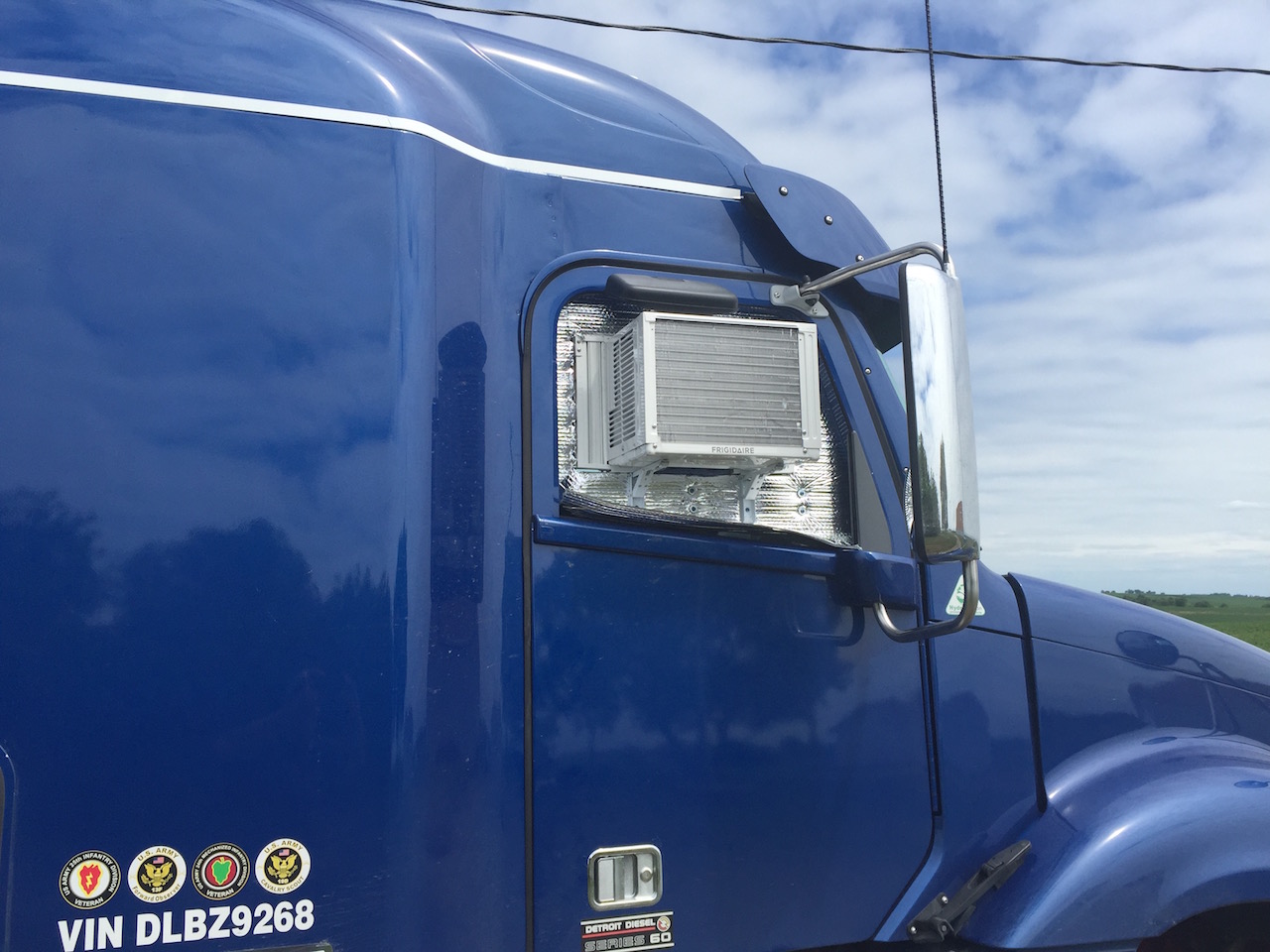

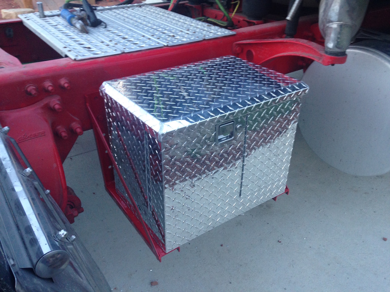

  9. Cowpie1
    Cowpie1 Road Train Member
    5,569
    4,652
    Nov 25, 2008
    Kellogg, IA
    I have had a Yamaha EF2000 on the truck for some time. Best thing I ever did. Mounted in it's own box on the frame rail, and can run right inside the box with the side panels removed, so it is protected from weather. I run the cord from it to the Xantrex inverter/charger under the bunk and it keeps batteries fully charged. That same line is hooked up to the oil pan warmer in the winter. It takes care of a window A/C unit I use. No one has ever questioned what is in the box. Easy to remove for maintenance and use for other projects around my property.
