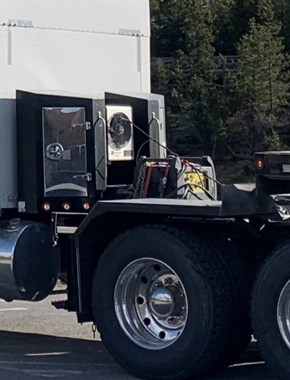

    Generac iq 3500 closed frame unit. Will set you back around 1200.00; buy a cover for it and use a few extra bungee cords on it when traveling.
    Simple set up bolted down right behind cab. I just had to move my service lines back a bit.
    Piped exhaust to rear of tractor with 1" flex steel. You couldn't see it, so it didn't look like some hillbilly set-up.
    Pull the canvas cover off when you need and your good to go.
    Gets about 9hrs run time.
    Sold the truck so I can't really say how long gen lasted.
    I had unit wired from 30amp RV plug to a Espar bunk heater, block heater, and bunk inverter. Summer times I used with a oscillating fan; no way I was mounting a window, or RV AC unit on my rig. Draw the line there.
    I did the gas gen thing, all said and done 1500.00 plus cost. So as long as its done right and looks professional it is your choice, but!
    Have to fill unit when you start your 10, and right before you turn in for sleep.
    Worry about keeping your gas can full.
    C02 issues; my monitor in truck went off twice, either due to wind or snow drifts.
    Bad idea piping any combustion engine exhaust to another, could back feed to sensitive engine sensors, which could lead to trouble.
    City flood pumps, compressor stations, or big multi back up power units all have independent exhaust.
    All that being said, and for the AC side, diesel factory APU would be the only way to go. Cost ya, but in the end much better set up.

    Elroythekid, on your original question about box. I seen a person parked once with a Montezuma tool box that was cutted ( mounted on side frame rail: SM200B), just using this number so you can see box. This is on my farm/Work truck. He/She had had an aluminium version (might have been a ranch hand or after market no name) and a little bigger. Lid was open and a Yamaha closed frame was running with extension cords through bunk side door.

    I went as lazy as you could.... I literally just chained it to the catwalk.
    Never had anyone complain or any smell in the cab.

    That is pretty much how I mounted my Champion. Except, I used u-bolts to secure it to the catwalk. Without a box over it however, it was destroyed by the elements. It got old and rusty way before its time. It's now at the house as a backup for our frequent power outages in N. Arizona.
