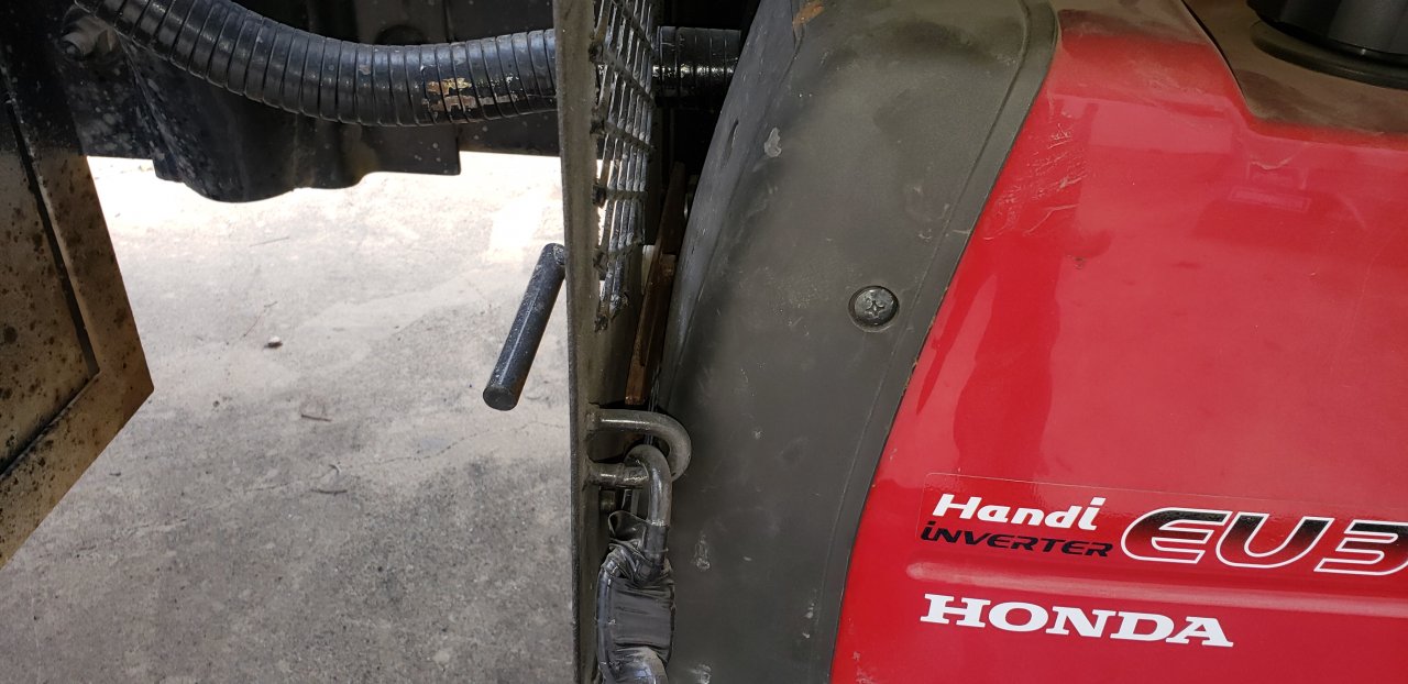

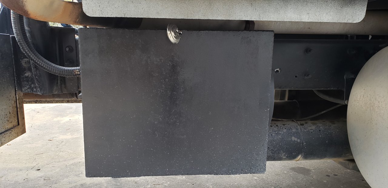

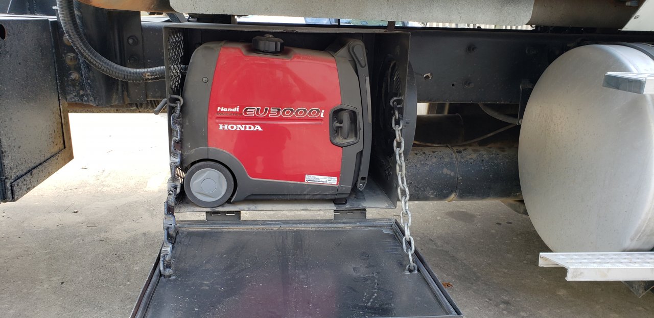

    The fan does 2250 CFM. I've got it wired to a switch on my dash. Without it, the box got so hot you could barely touch it, and it caused the generator to kill the power. With the fan, it stays ice cold. Runs all night on the truck batteries no problem. Pulls 90 watts.

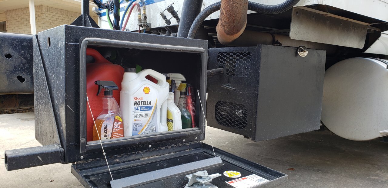

    I forgot how many pounds of gas we can carry in cans, but it equates to 8 gallons. So I carry a 5 and a 2.5 gallon can. I drilled a hole near the top on each side of the toolbox for venting hot air.

    Nice setup man! Thanks for the pics
