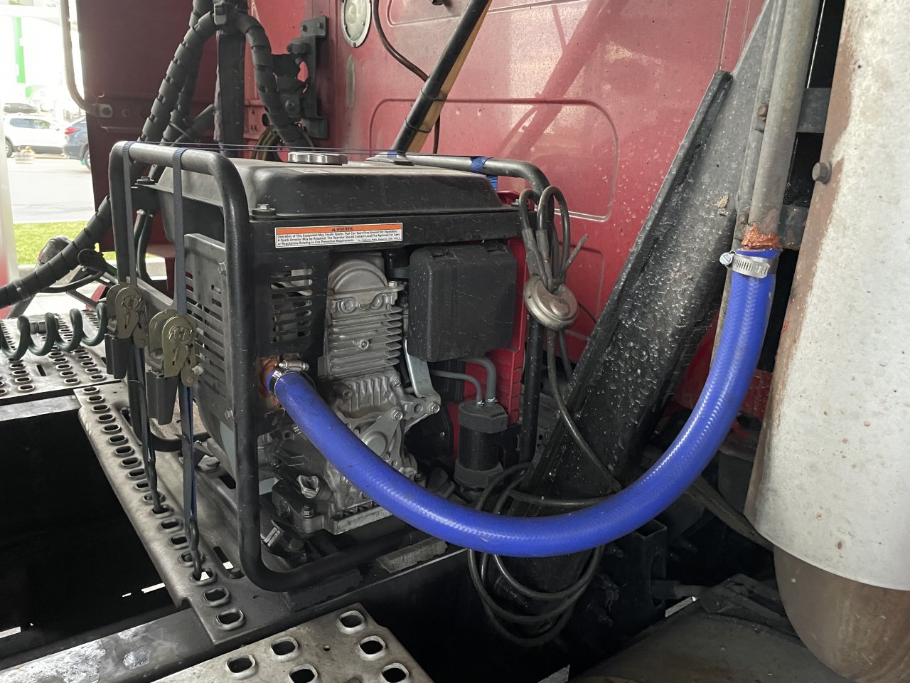

    If you run a generator on your catwalk, you also need to hook up an exhaust stack so you don't kill your neighbors.
    That is 1" high-temp silicone hose connected to 3/4" electrical conduit which is hose clamped to the truck's exhaust stack. All generator exhaust exits above the cab.

    I made mine out of 1" flex pipe.

    Anyone ever plumbed the exhaust into one of the truck stacks? Wonder if that would work?

    I thought about that a while back. I'd worry it would flow backwards and leak if you have a bad flex pipe at the turbo.

    I wouldn't want it back feeding into the pipes under the cab. That could be deadly.
