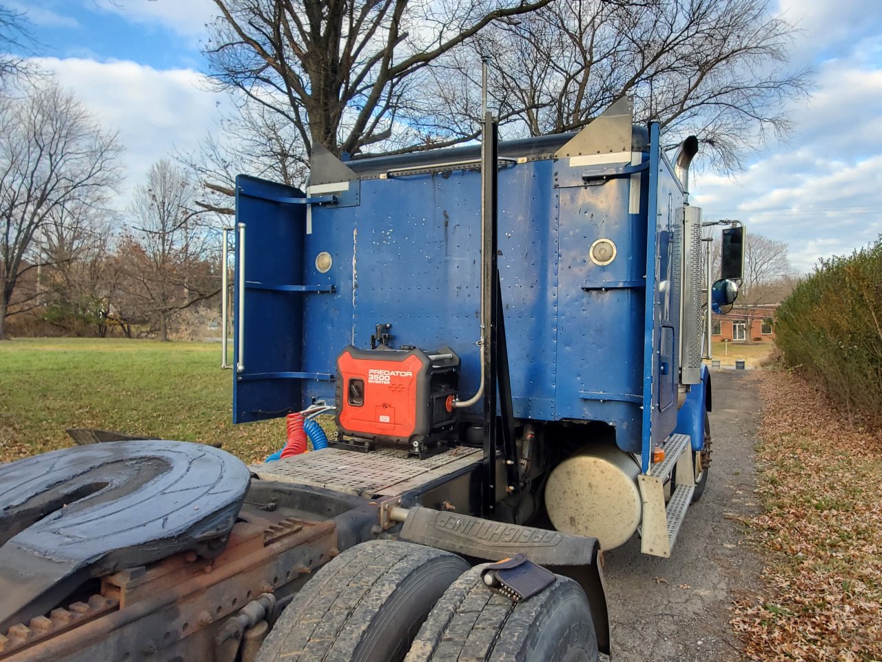

    So far it's been great but I don't have a lot of time on it yet. I did the first break in oil changes and now I probably only have about 20 hours on it. I'm going to try to keep changing oil as often as I can.
    The only problem that I've had is that the exhaust on mine is not the same as what other people have shown in their photos. They're supposed to be just a straight pipe that comes out of the back end that you hook your pipe to.
    Mine had a weird flange on the back and a pipe actually inside of that but not sticking out that you just hook up to. I had to make another flange to fit up onto that. It's okay so far but if it had the little pipe sticking out it would have been so much easier.
    But the generator is so far has been great. On eco mode I can run the space heater and at the same time I can run my block heater.
    Last night it was 4 degrees and my truck started instantly. Gotta love that.

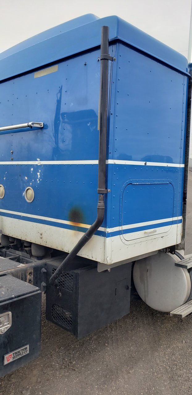

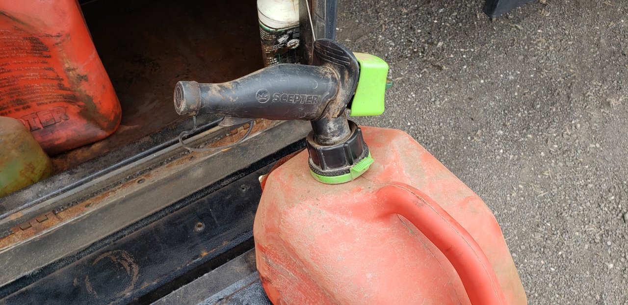

    I guess it's "Scepter", but anyways...

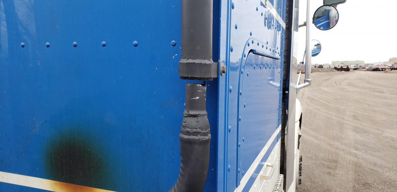

  10. God prefers Diesels
    4,198
    22,266
    Jun 26, 2020
    South Texas
    Yes! It's better than my old design, because it eliminated the flex pipe, and still works as a venturi. It's about to get yet another small tweak when I get home.
  11. Crude Truckin'
    Crude Truckin' Alien Spacecraft
    2,460
    6,872
    Oct 22, 2016
    North Dakota, Eh?
    I'm assuming you put that on there to draw in some fresh air and keep the stack cool?
