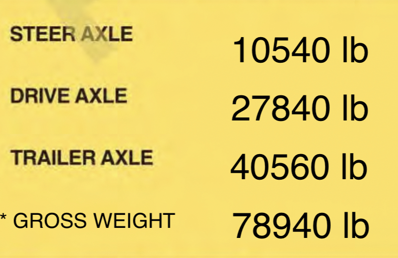

    First I turned the blade straight and moved the machine forward a foot or two keeping the blade on the lower deck. I weighed it and got this.
    All I can figure is on the original weigh I didn't have the all the trailer tires completely on the scale.

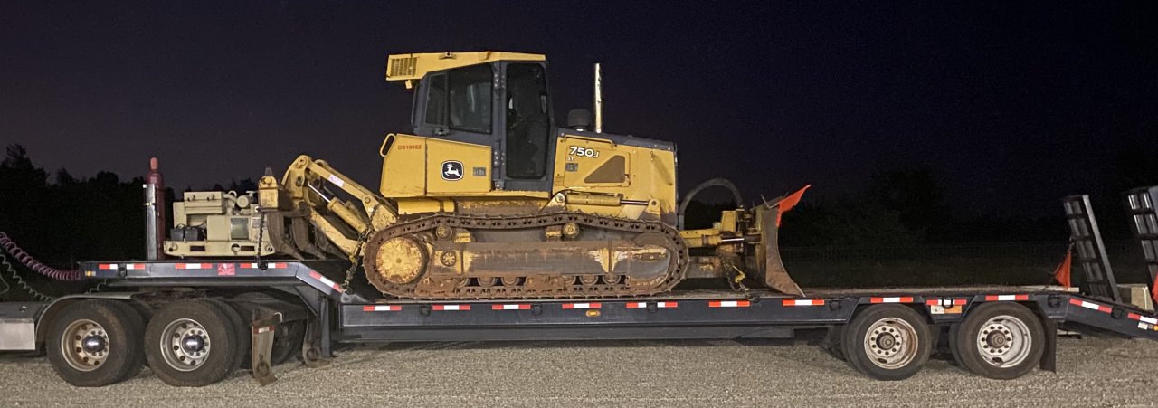

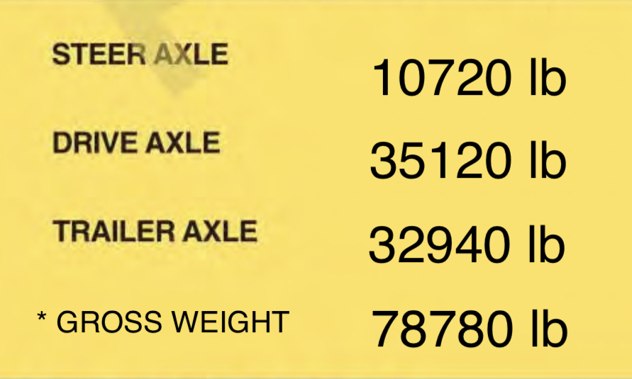

    I went to the scales again and got this. Looks like I just need to move the machine back a tiny bit and all will be good. I am surprised the steer only went up 180 lbs. My fifth wheel is as far forward as it can go without the trailer hitting the mudflaps.
