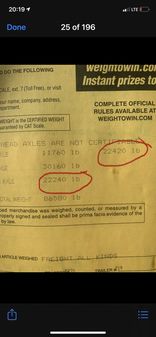

    Something is seriously wrong with your spread axle trailer. Your axles should split out within a few hundred pounds. Here’s the last split weigh I could find with the two axles circled. (Ignore the over weight issue, dog treats are freaking heavy) 3C6A95F4-F88A-44EA-8DCE-B66D33BD0CF0.jpeg
  5. TripleSix
    19,108
    133,640
    Winner.
    I would like to see the axle weights on an empty trailer for that very reason.
