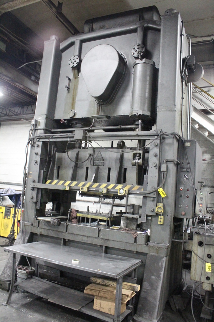

    I am an Illinois private carrier. I own two semi trucks, Freightliner Columbia and Freightliner FLD.
    I never do straight trucking/hauling for others, I use my trucks to move machinery and do scrap metal.
    That said, we recently bought a 30 ton 2 axle gooseneck trailer and it looks like we will be hauling heavier loads.
    My question is, 1) how much can I realistically haul with a five axle combination vehicle with drive and trailer axles at 20,000 lbs each, without blowing up tire and breaking anything and 2) Do you have any advise for driving while heavy. Say, I had some trouble starting uphill when heavily loaded. That sort of thing. Thanks clearing.jpg
