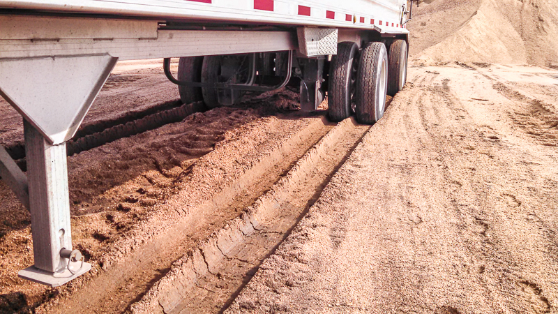

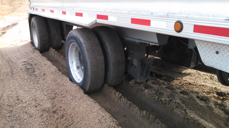

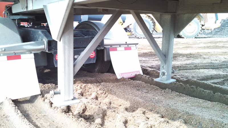

    We have an asphalt plant we haul sand to, one of APAC's . I absolutely hate hauling into their sites. The wheel-loader operators are morons. They don't know how to maintain the areas so frame-less end-dumps can dump on somewhat level ground. If that's not enough, it is always waaaay too soft. :mad:

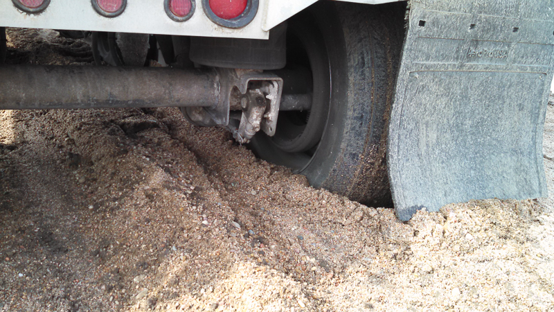

    We're suppose to back up to within a couple of feet of the pile, however it's just not possible. The past week I've got stuck every time. Each time I've had to get myself out. Why? Because my tow-hook or pintle hitch's pin bent when the loader tried pulling me out. Yep the pin bent, and pulled through the bumper.
    Here's a couple of pics showing how the tractor and trailer sinks. I just back until it stops, can't go any further and can't pull forward.

    Ok, this is a lot different than the other place you showed. ( although, I have been in situations like this) This is clearly unacceptable. The best thing you can do is have pictures of this. You didn't mention if it was your truck or not, if it was my truck, and they complained about it, I'd run up on the scale, and let 'er go right there ( scales are usually nice and level), and say, "Have a nice day".:eek: Loader operators can be the laziest schmoes on the planet, kind of like forklift operators at union grocery warehouses. They don't want to scrape the pile too close to ground, in fear of contaminating the sand with whatever is under there, but they could "back drag" it a little better. Don't be intimidated by these clowns, you are at the controls, and if you don't feel safe, don't do it, and take the sand back to the pit, and do something else. It's not like there aren't any other opportunities for drivers these days. Good luck.

    Last Monday, I done just that. I had the bed in the air, the sand was packed against the tailgate, axles and worst of all the brake pods. I had to dig the sand away from the pods so I wouldn't tear them off. This is when the pin to my pintle-hitch bent. Loader couldn't pull me out. That's how stuck I was. I had called dispatch, and he ordered a tow-truck. However I wasn't going to sit and wait for who knows how long for this tow-truck. So I continued to work on caterpillaring. Finally one last attempt, setting the parking brake, I managed to get the hydraulics to pull the trailer. Before it would just slide the tractor backwards, with the brakes set.

    Something you can do in those sorts of situations is to draw the tractor back as the trailer is going up ONLY until the pile starts forming behind the trailer. Then, nice and smooth, release the trailer brakes and set the tractor brakes. That way, instead of "digging in" as the bed goes up and all of the weight is transferred to that one axle making it impossible to pull forward, it will draw the trailer towards the tractor for the last stage or two. Then, because all (or almost all) of the product is on the ground instead of still being held in the trailer, and the trailer axles aren't dug in, you should be able to ease forward and start lowering the bed. If you're still worried about being stuck, lock in the power divider before attempting to pull away as you're lowering the bed.

    1. I always, always lock in the power divider when driving off of pavement, well except for a few county gravel roads. The ground here is very spongy even when dry. I don't know why the ground was hard in the one area on the other side of the "new" sand pile.
    2. I always start my dump, by setting the trailer brakes using the trolley bar since it applies more pressure then the "red knob" emergency valve. So I always walk the tractor back first. I have a certain depth I watch for the material to be at coming out of my trailer before switching from walking the tractor to walking the trailer forward.
    The trailer and tractor tires would start sinking immediately. In fact, it determined where I dumped, since I could no longer move without spinning, ie; hoppity-hop. I also like to flatten/level where I dump in these areas, by driving forward and back a couple of times if possible. However not so in this area.
    3. The rear trailer tires would sink more when the bed raises, causing the "dishing" under them, and the sand being piled up in front of them when I attempted to pull the trailer forward.
