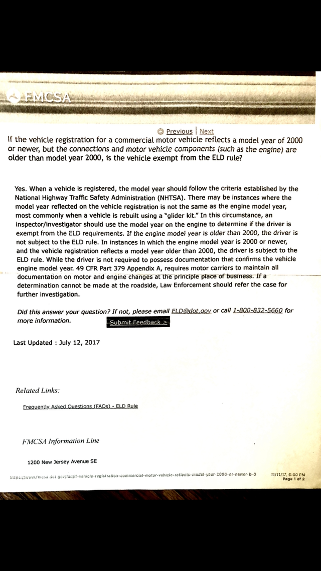

    34DA9491-05D3-4F96-844B-1E7A32086788.png My Trucks Title says 2001. It’s in the Freightliner parts system as a 2000. Engine build date is Nov. 99. It’s not a glider, but is exempt. I’ve Been asked during an inspection a few times. I explain. I carry this Letter, just in case. 2015 is before the deadline, for Pre emissions Glider sales. I doubt it would be a problem. Gliders have been around forever and will be. It’s only the ELD exempt part they’re worried about. Prior to 2000 is a date they settled on, since Mechanical engines may have still been available till then.

    Thanks! I assumed with my block being 04 it would be a problem. I dont care about elog, I do dedicated now and have lots of hours, it's just this version seems to not work properly with ddecIII . The install guy is going to email the provider and ask what they can do.

    Should be Ddec IV or V. If it’s a 14L probably a V.

    The blocks good, everything’s good. Lol. Don’t know much about it. I’ve heard that the older pre 99s like mine will work, just won’t show exact miles for the IFTA reporting bonus feature of the e-logs.
