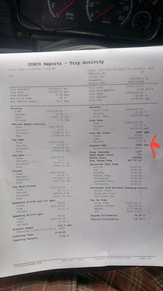

    I'm not sure how many CAT engines will do this and still run after. 20171216_004046.jpg

    And that means what? Oh an idiot was involved. Who ever owns that truck got lucky.
    I have run narrow journal 3406B's with a 14613 and 3.70 rears at 2150 all night night after night hauling cattle out of South Florida to liberal. Never lost a crank in one of mine. But I know plenty of people have. Wonder what the difference is???
