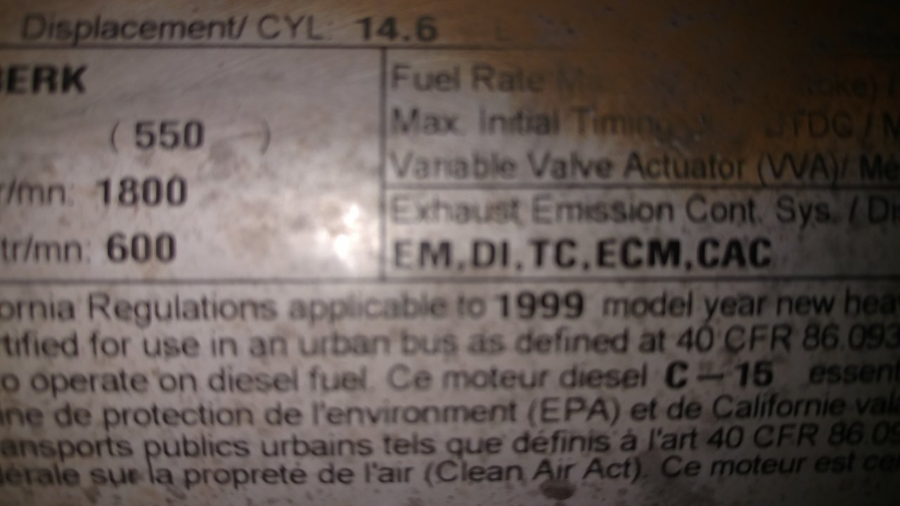

    Not very good, I might have to try again. I can't get my phone to focus well in the dark. That, and the shop did some work on it and got some overspray on it. IMG_20171212_192227344.jpg Dang, you can't quite read it, but it says that it meets EPA and California CARB specifications for 1999 engines.
    Let me try to get a better picture, and I'll take one of the door jamb stickers as well.

  8. Oxbow
    Oxbow Road Train Member
    13,985
    146,136
    Nov 24, 2015
    IMG_20171212_194608320.jpg IMG_20171212_194736623.jpg With the hoses to the turbo, and being dark out, that is the best that I can do. You can make out that it says that it meets 1999 standards though.
    There are other stickers on the door jamb as well, but nothing related to emissions.
    The EPA sticker is on the oil cooler.

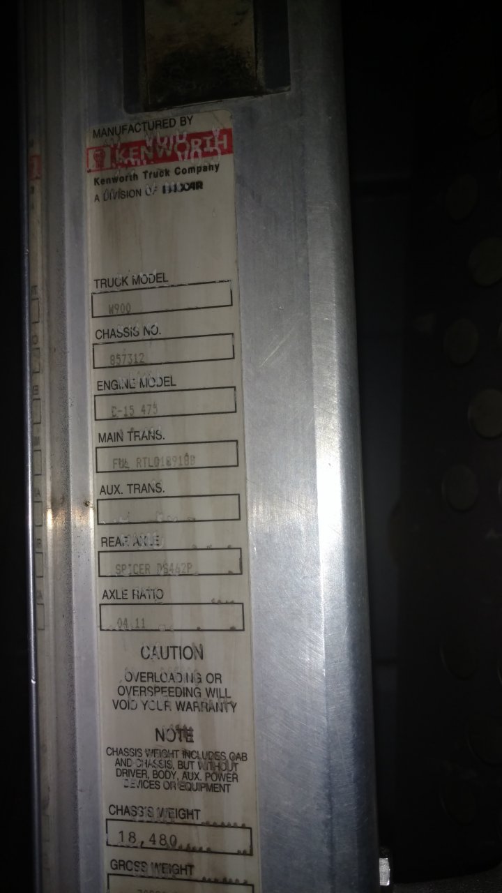

    Now here's why I said it was interesting, on my 2000 W900, it's got 11/99 build date.
    My door jam sticker just says 3406E 475 98+, but then again mines a 2ws not 6nz, so I was curious how they would word a c15 on the door jam. 20171212_221912.jpg
