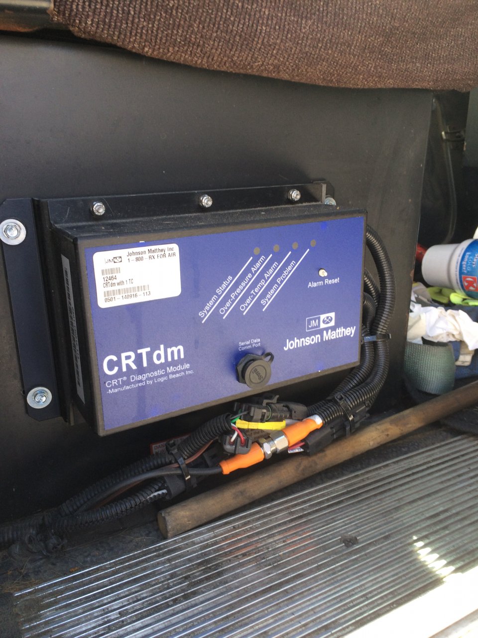

    That's how mine is mounted, but my Filter is a little bit larger in diameter since it's for a 14L N14 vs a 11L M11, and my install was $13,100 because of the larger Filter.
    A2Z Emission Solutions was bought out last month by Diesel Emission Service in Ontario, CA.
    The prices are about $1500-$2000 more for the same Filter with labor as they claim their install is better engineered then A2Z's was, but I say B.S.

    You want a perfect install.....look at mine. Fletcher's is the way to go.
    Bakerman and Terry270 Thank this.

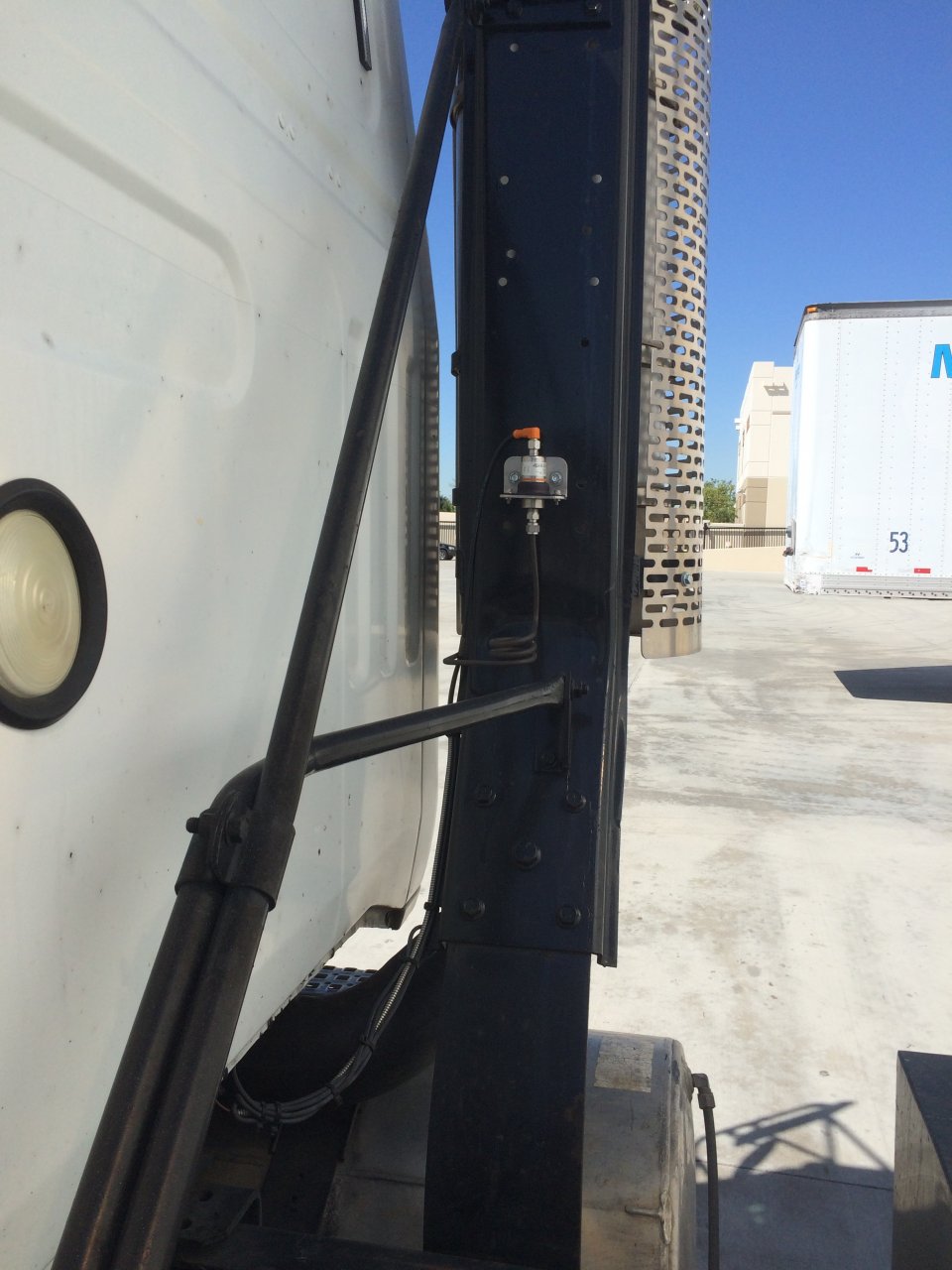

    diesel dave are you running yours under the bunk then out thru your pipes?

    He has his installed with a horizontal HUG Filter Systems filter enclosed in a special Step/Battery Box that connects to his stacks.
    Diesel Dave Thanks this.

    Yes, hook up to the y and out the dual straight 7" stacks
