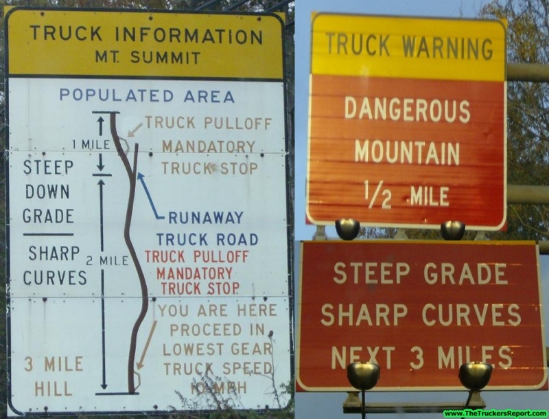

    Look familiar?

    How so??????
    You mean you never use brakes going down Cabbage, the Siskyou, Grapevine, Cajon, Vail?????
    Funny.....every time I go down those grades...I see brake lights......

    The hill in question isn't an interstate highway. It's on rt 40 in Pa between Uniontown and the Md state line. Pa has a number of hills like that in the 9% - 12% range. There are exceptions to the 6% maximum on interstate highways. Ask anyone who has been across I 64 just east of Beckley W Va, the Sandstone grade. It's a steady 7% for 5 miles with 2 escape ramps that have seen a lot of use over the years

    I have been on US 40 there before uniontown (my gps showed me that was the fastest route on the way back to the toll road). There were a couple of spots I felt like I was on a rollercoaster and I was very very happy that I was empty. Some of those towns through there though bothered me more than the grades did.

    Good old Rt 40 that SOB is a FUN Mother ain't she. Try hauling Haz-mat to Baltimore guess which way I had to go. I-68 here was the fun part my regular trunck had busted its 5th wheel when the day BEFORE I was due to leave another driver used it as a spotter to move a trailer. He backed into a trailer with the jaws clsed and broke them OUT of the 5th wheel. Well the only tractor left in the yard was the spare. 88 Pete 362 COE with a 310 Cat 9 Over with NO JAKE. Here I am going to freaking Baltimore with Flammibles on and I have to go sans JAKES.
    I was the only driver aviable that had Haz-mat in the yard at the time so I had to make the run. Needless to say on Sandstone I was pulling Seat Cushion OUT OF BY BUTT CRACK by the time I got to the bottom of it. Get back to the yard got my regular rig back and told my bos Retrofit some kind of Jake into this SOB before it kills a driver. This truck normally only went between the yard and the Railyards doing the intermodal work we had.
