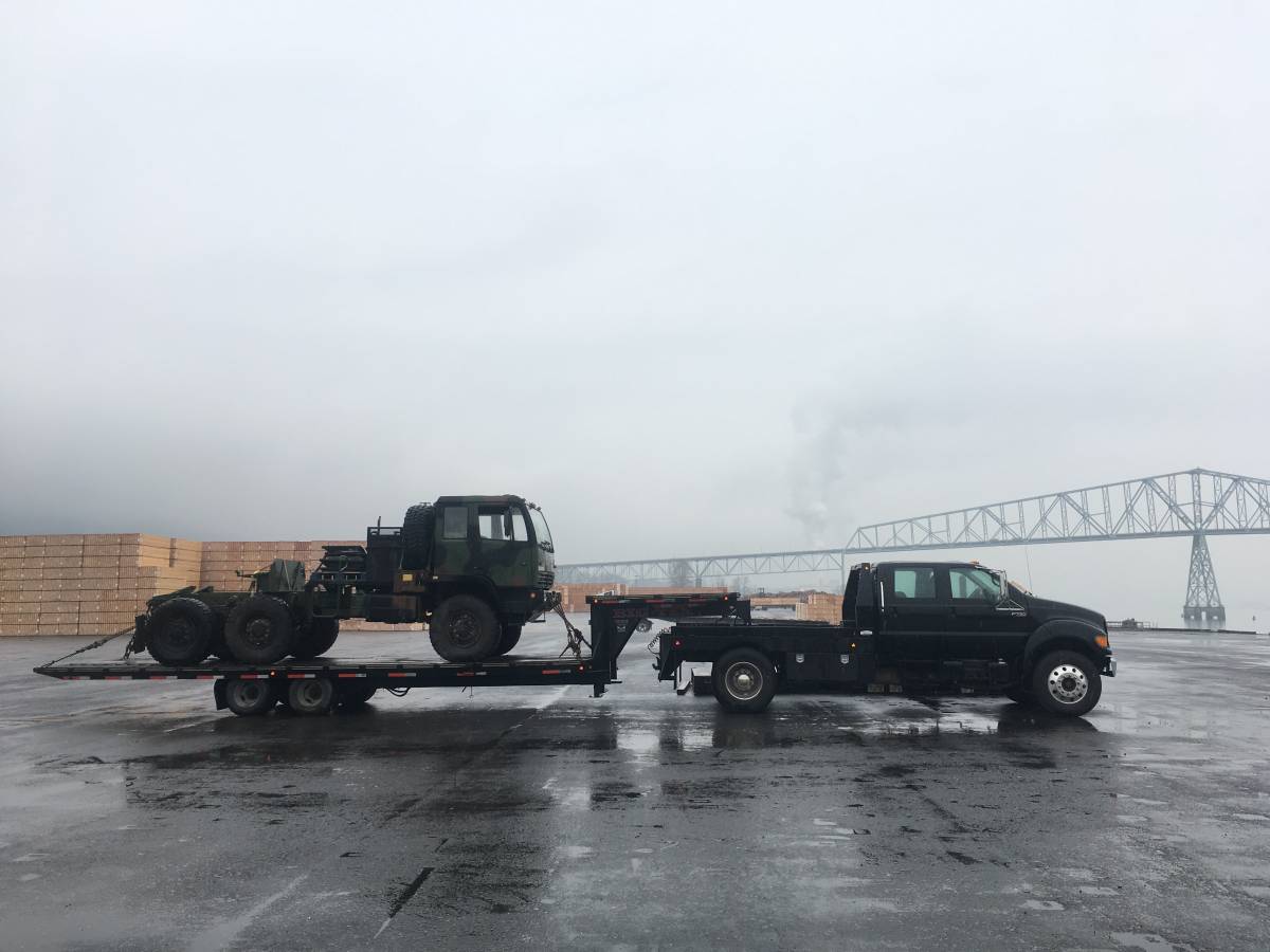

    I started with a 2001 F750 with 6MT and 275hpcat 3126, but hated it because it had no power. a 4500lb trailer behind on the hwy would make it hard to maintain 65mph on flat ground. truck wieghed 16k.

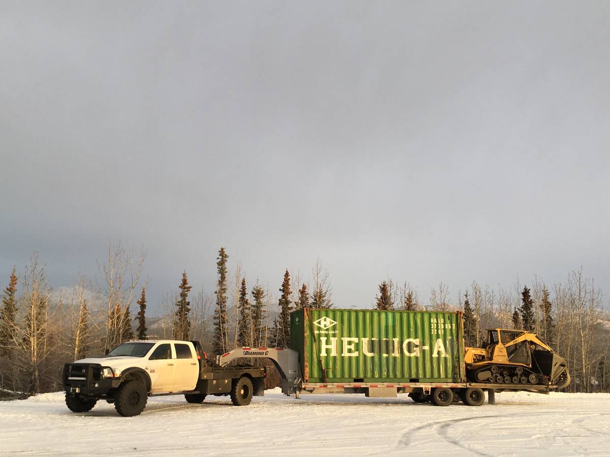

    SO, I switched to a 2011 ram 5500. truck has 300hp cummins, 6mt, 11,200lbs and outpulls the ford all day long. I can not only run hwy speeds at weight, but I get same mpg (5-7mpg) But after a transmission and an engine in 10k miles, im over the 5500.

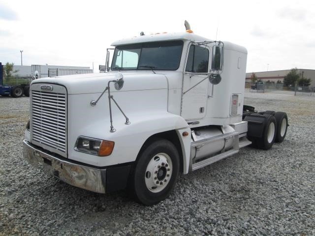

    Ive been trying to avoid a class8 truck to pull my goose. But today, I found a 1994 FLD120 flat top with a 60series and a 9 speed. under 500k miles, for $6700. Needs paint and some minor reconditioning, but I feel like I could be into this truck around $10k all in. Compared to spending 30-80k on another class6/7. its got pretty short legs- 4.10 finals with the 9 speed. but I still think it would run circles around the other options.

    I run a '93, baby 11.1L series 60, 4.10, & fuller 9. On tall 22.5 rubber it will only do 72mph wide open. But if I feel the need, it will do just that all day. 54,999 gross weight. It's down on mpg's right now, but still averaging 7.76..

    --Yes, I like it. Don't know what the inside of that one looks like, but from the outside it looks nicer than mine. I'm pretty sure my mpg has fallen because the overhead was adjusted poorly. It sounds funny too me right now, & I need to find a different shop to do it again..
    --Mine was originally built from the factory as a single drive axle..
    --I pulled a gooseneck with for the first 2 years. My insurance went down ~$3k when I switched from a 2012 3500 dodge. That's plated for 54,999lbs vs 36k lbs dodge. Keeps you out of 2290 heavy use tax. Maintenance seems about the same, but it did need some work to get DOT legal. Parts are little more expensive than a pickup, but should last longer too..
