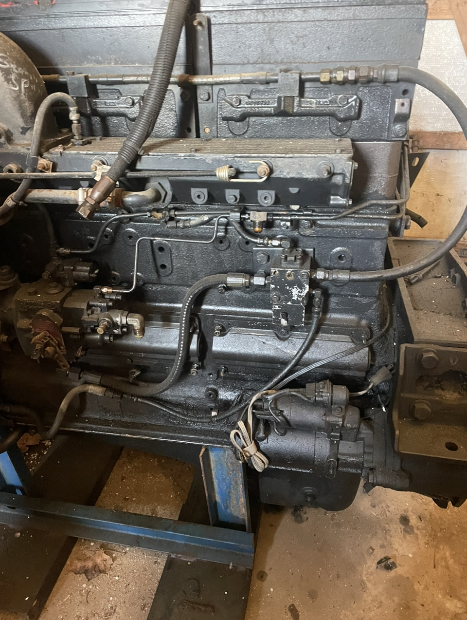

    The gaskets that came in the PAI kit back during the pandemic were not a 1 piece gasket. Was having trouble finding parts because of shipping at that time. My experience the green water grommet seals don’t last as long as the original Cummins. Good thing about the 855 & N14, they use the same head gasket.
    I found a mechanical N14 from a local guy, been talking to him about it. It’s complete with Jakes which is a plus. Actually entertained putting the 7FB in my W900, but hate to transgender the K100 with a Cummins since it came factory with a 3406A. My W900 is a factory glider, it don’t know what it is lol….
