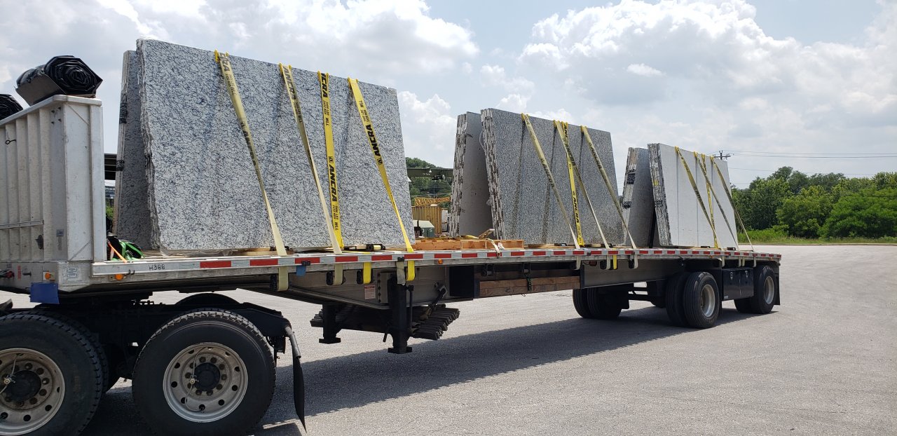

    So here’s the deal. I am transporting huge slabs of stone/granite on A-Frames. I put edge protectors on top and bottom of the cinch straps (2”). Then 4” straps up over those. I used the disposable edge protectors on some and my own plastic (MyTee) ones on others after like 200 miles they were cut through a third of the way. Why??? Also so now I put new edge protectors on top of the old ones (which still had the 2” straps over them because only the 4” were cut). Hopefully it’ll last the 4 hours I have left to arrive. Any recommendations??? Please

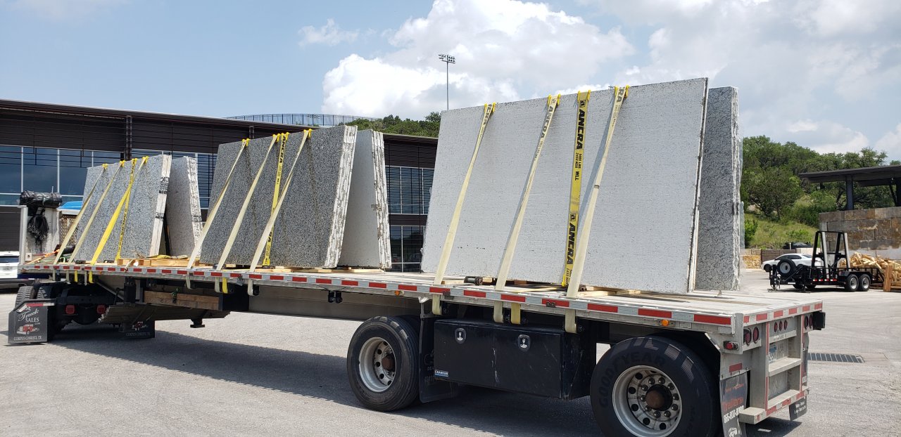

    I hauled those once. The loader told me to use 2" ratchets to cinch, and throw the 4" over them on the same edge protector. I just gave him a stupid look and did it my own way. 4" cinch, and no shared protection. No issues, and here's what it looked like:

    Geez! I was thinking about ignoring him too because it didn’t sound right. But now I cut up one of my coil rubbers into 4” sections and I am currently using those as edge protectors. It appears like the plastic ones melted. Weird. Next time I’m going with my own way too. Could be the high winds on I-80 going to Salt Lake City from Cheyenne. I appreciate you getting back to me so quickly.
