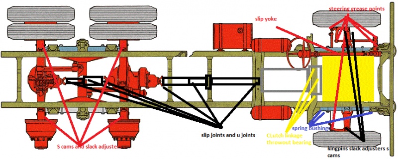

    Hello, does any one knows where I can find a diagram for location of grease fittings on a kenworth T800 1999 ?

  6. Ezrider_48501
    Ezrider_48501 Road Train Member
    3,845
    5,135
    Apr 2, 2011
    bismarck, nd
    i did a quick Google search and didn't come up with any kind of grease point diagrams so i threw this together quick. should point you to at least the general area of most of your grease points

  7. ralin10
    ralin10 Bobtail Member
    41
    4
    Apr 24, 2014
    Thank you very much.
