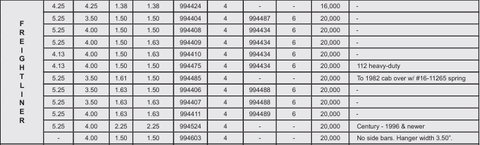

    Looked up based on my VIN I need a 994401 kit. Which is actually a Peterbilt number based on hortons parts catalog.

    Horton shows this for Freightliner.
    Kruse Family Farms Thanks this.

    So I called another Freightliner place and they said my VIN shows a 994408 which is in the Freightliner category for the catalog. However those measurements are incorrect for leaf spring and spacing etc etc. I have to pull it apart and measure all with calipers and go based off that based on the catalogue.

    94408 is the one for a 2000 Freightliner! Appreciate the help from everyone. Found some cheap on eBay. Looks like it should be pretty easy to put them in. Thanks again and have a good one.
