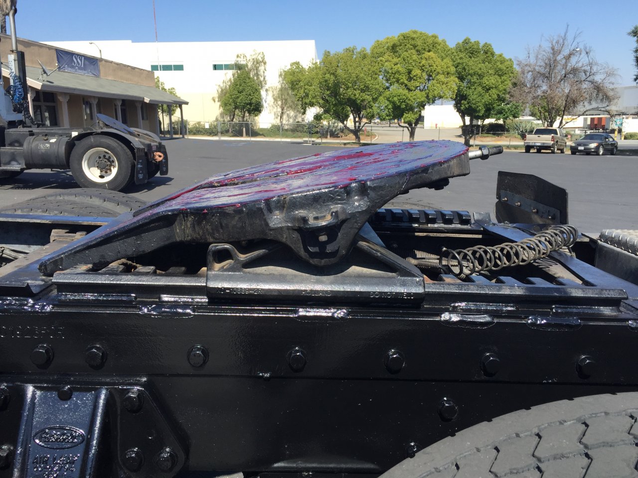

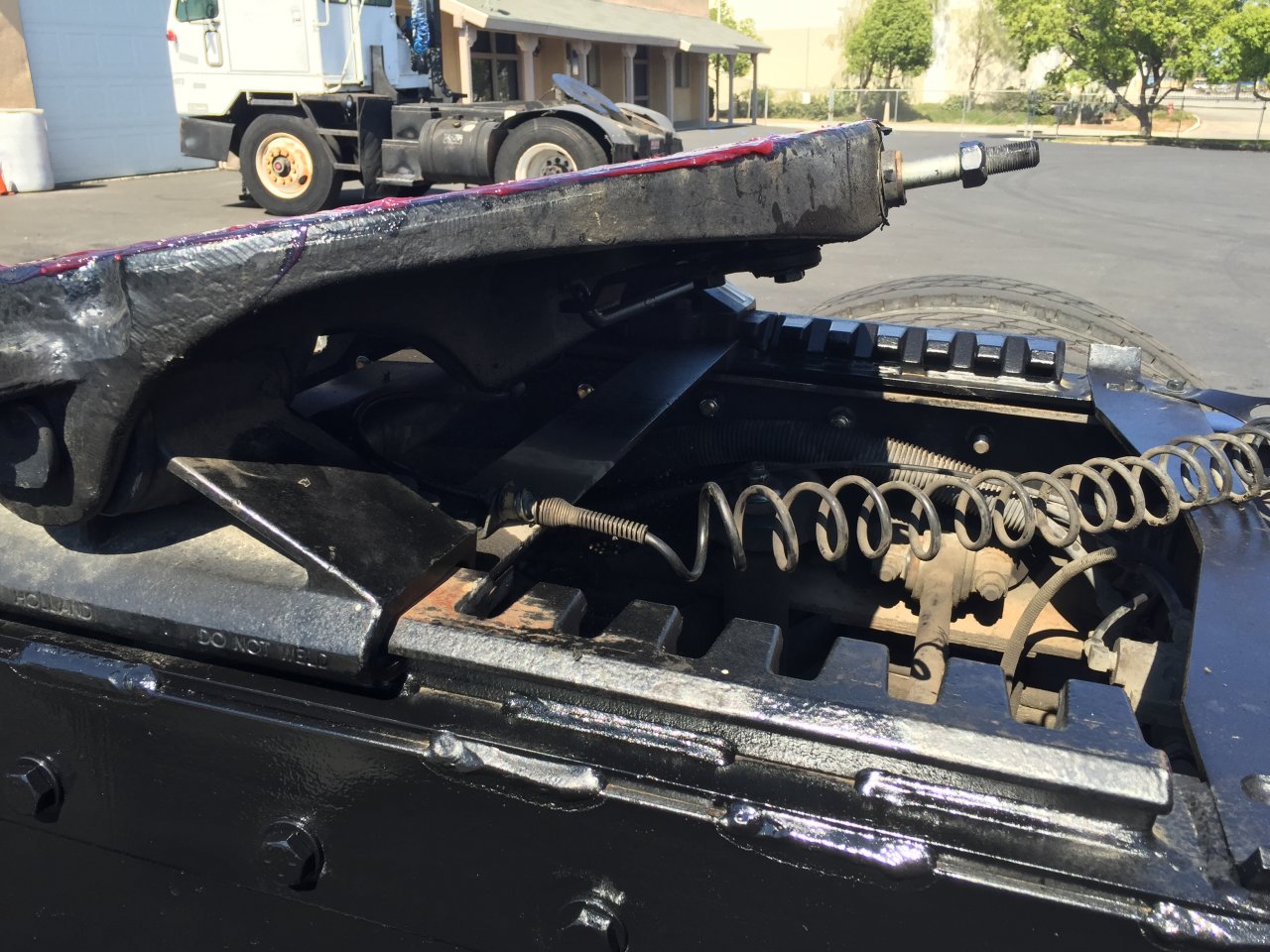

    IMG_0134.JPG IMG_0137.JPG I just installed a complete Brand new Holland fifth wheel with slider. What caught my attention is, there is no grease nipples to grease the pivot points. How long will these bushing last ? Also, the slider has a different locking teeth. Is this a plus or minus ?

    My new fw35 has the updated style pins like yours too and no zerk fittings for grease either. The new pin style is much easier to replace doesn't bother me that I cant grease them.

    I hate that type of 5th wheel slide. What happens is stupid drivers (we don't even get to slip seat an assigned truck, it's what's available) drop, or even hook up at an angle and then slide. The 5th wheel has so much play in those teeth it will twist and pin itself at an angle. Take a large sledge beating on it to get it to release the pins so it will slide again.
    Since it's your truck, simply don't try and slide while at an angle and you will be good.
