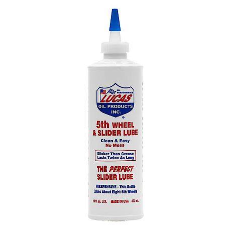

    I had looked for an image to add to my post, then forgot to do it LOL. The image came from Advance Auto Parts, on sale for $8. They do have this stuff in the store from time to time, but I never seem to need it when I'm there. The trick to use with Advance is they always offer 15-20% off online orders. I've actually been inside the store and ordered for pickup on my cell phone. I've already got enough or I'd have ordered some when I made that post.
    That said, I usually pick up a few bottles when I'm in Truck Pro buying something else. Usually $10 from them and always in stock.
    Pro tips: You'll be tempted to cut the tip on the funnel cap and use it like an axle lube bottle. That works ok in the summer. Save time by just unscrewing the lid and pouring it. It's a little messy, especially tiny spider-web like streamers in the wind, so be careful, stay upwind, and don't overdo it. Tip enough to start the pour, then adjust the speed to form a bead about 1/4-1/2" wide. I usually put 2-3 beads on each surface. Then like some others mention, drop the air before backing in and raise up just in front of the kingpin to reduce scraping it off.
    In the winter time at places I have to drop the trailer, I'll take the bottle inside the cab and put it in front of the bunk heater outlet a few minutes, up on a box or something before using. Put it in a grocery bag to keep things clean inside the cab.
    This is the image I forgot to add:
