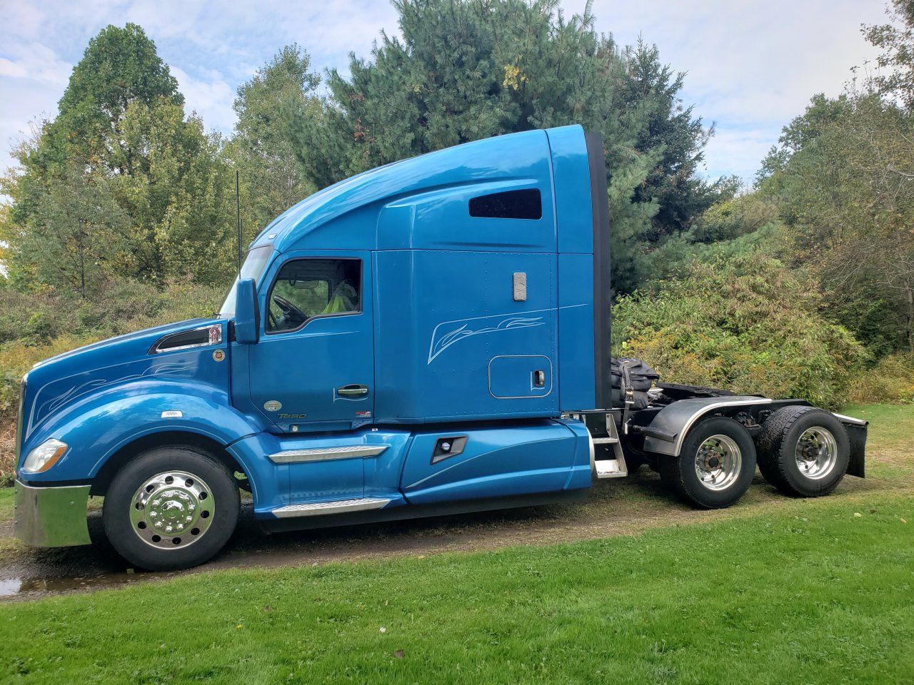

    Same color as my T680. So far I'm liking it after a year of use.

    Nice truck!!! I drooled on my phone a little.

  6. brsims
    brsims Road Train Member
    5,296
    6,522
    Aug 8, 2009
    Meadville, PA
    THANK YOU ALL!!
    Checking and (probably) rebuilding the fuel pump is one of the next projects. Basically, as soon as I find the buggering thing, ha ha!
    I love this truck! She runs beautifully, and that eight bag rear suspension system cannot be beat for a smooth ride.
    Did have a problem with the ignition system (please note the past tense). New batteries, new starter, new starter solenoid, new relays. Nothing done by the dealer prior to purchase provided a permanent fix. I got it to start by wiggling the starter relay, which got it home. But once I was in my driveway, even that stopped working.
    She started easily if I jumped the starter solenoid off the batteries, that was out. I replaced the starter relay, the ACC bus relay, and the LVD bus relay. Still no joy. Now I think I have it narrowed down, but I want a test and an informed opinion. So I took her up to her new mad mechanical geniuses and asked them to test the wires leading from the relay to the solenoid. Bingo! No power!
    $18 in parts, a couple of hours in personal labor, and I have a sweet old school push button start! The wiring fault is either between the ignition and the relay, or the relay and the solenoid. That will have to be tracked down and repaired, obviously. But now the truck fires up strong and solid every time.
    The longest part of the operation was making it look as close to factory as I could. Plus, built it theft deterrence, bonus!
    Now I have to check the fuel pump and tinker with the APU. For some reason, the APU (HP2000 with the Perkins engine) isn't getting any electrical power. I'm thinking it's either a bad connection somewhere, or a blown fuse.
