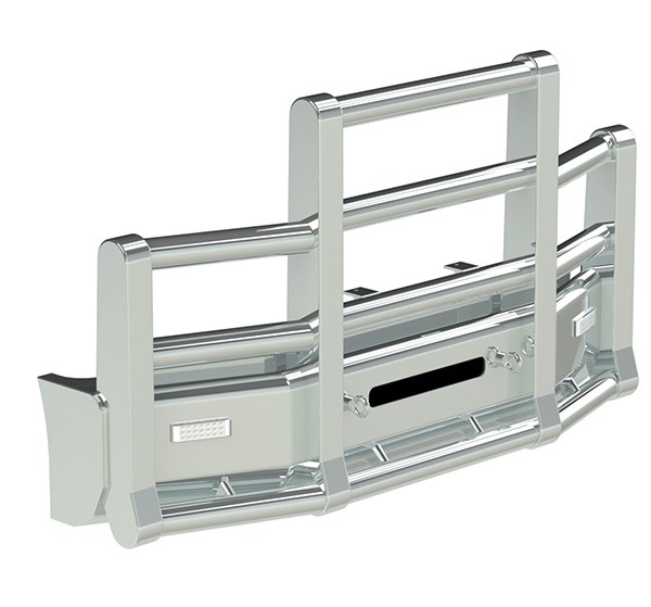

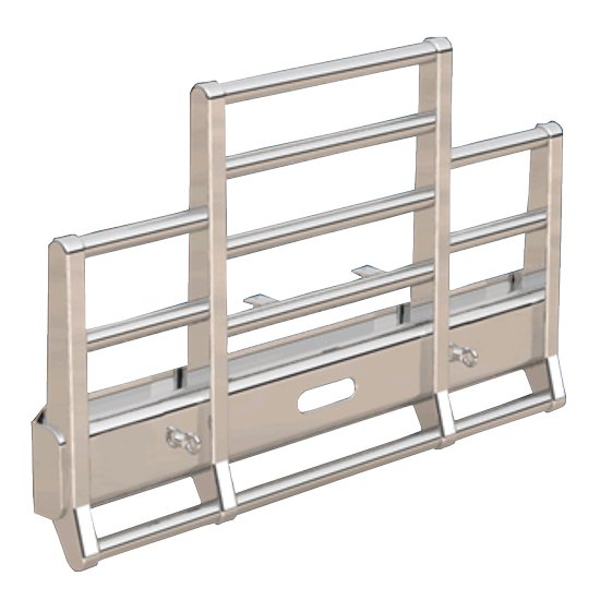

    We run about 45 trucks on long to medium distance mail runs. They all have a deer bumper of some kind and they've more than paid for themselves. We started out with Ali Arc bumpers; downside was cost and some drivers, women, found them too heavy to close. They definitely hold up to multiple hits. We bought one Herd Super Road Train for a W900L; downsides are cost and much too heavy for our older drivers to close although the new slam locks will make that better.
    We now use a bumper made by Ex-Guard; so far no downsides. They tolerate deer hits quite well, cost less than half of an Ali Arc and much easier to close and lock. Also these allow you keep the stock bumper in place and are just an add-on type of bumper rather than a replacement like the Ali Arc or Herd.

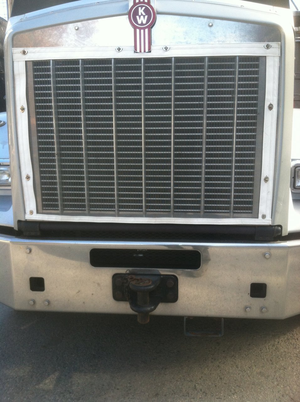

    Does herd make a super road train with a cut out for the kw center mount tow hook?
    Would be looking at this one...

    No. The original bumper gets replaced with a huge support for the Herd with it's own tow pin.

    Well that sucks... my tow hook is not part of the bumper...
    I'll have to call them...

    The two eyelets are what hold the bumper to the Herd undercarriage. Below those are two hinges for the bumper. Neither would hold up under the kind of strain you'd likely put on that bumper trying to pull it out out of something. The slot between the eyelets is where the tow pin goes, that is anchored to the frame of the truck. Any behind the bumper support you have for your factory tow hook will get replaced by the huge Herd piece.

    I've attached a couple pics of the Herd SRT bumper we had on our KW W900L. The first pic is the undercarriage that gets bolted to the frame of the truck. The second pic is the backside of the actual bumper.
