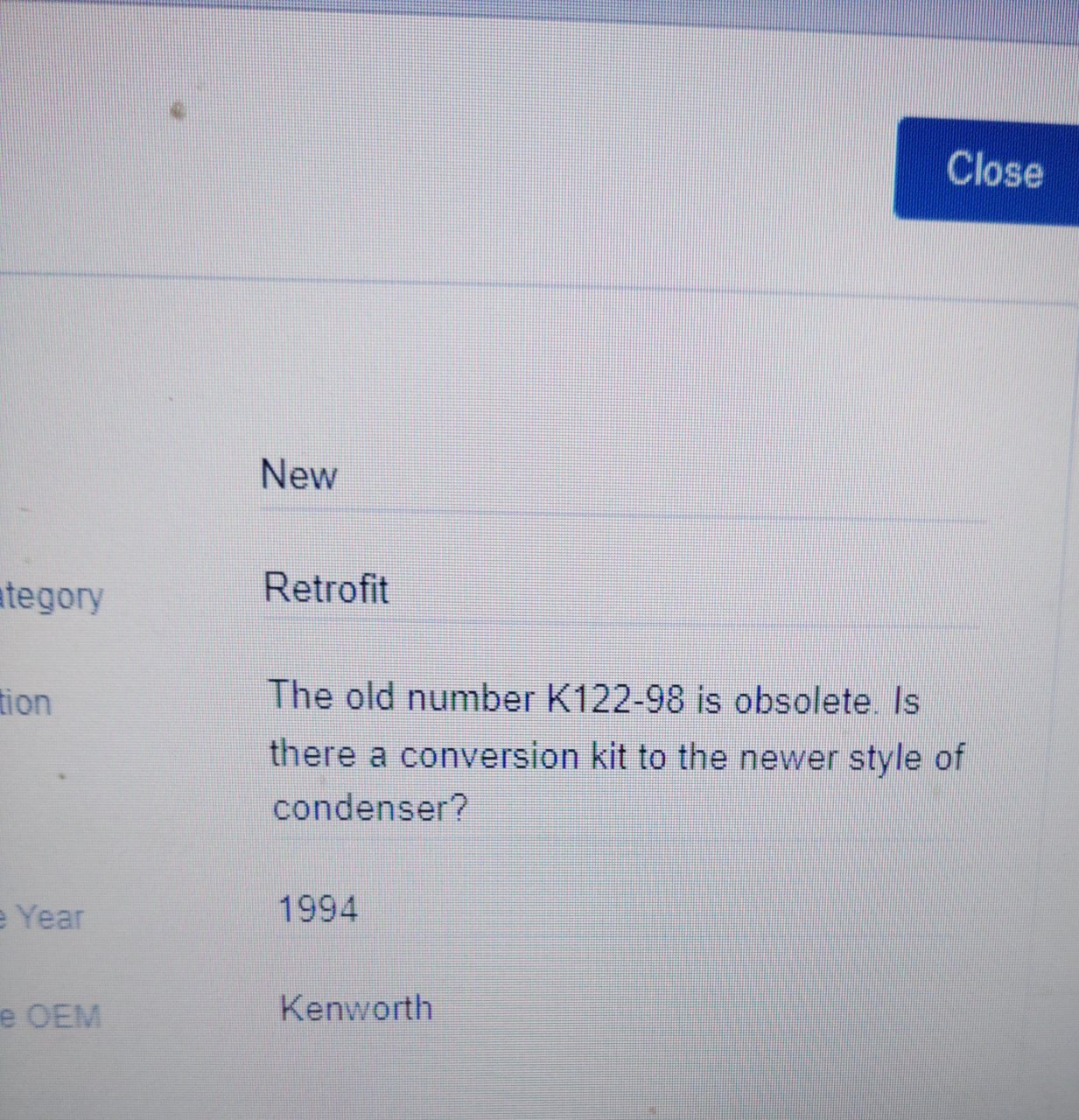

    What do I put there? Do they make a R134 Grilldenser? KW tells me there's no superseding part number.

    Same deal. Discontinued and they told me to try Vintage Air.

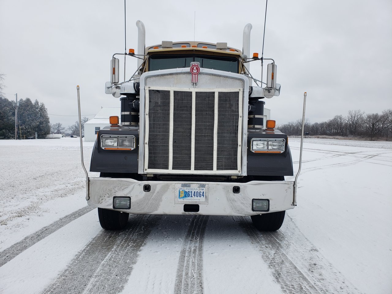

    98 w900 we put a regular normal condenser on it. The grill condenser was close and rub the first one. Adjusted the radiator support bracket back a little more. And still was close so changed the grill to an after market that was thinner. Its worked great.

    The only picture I have of the grill at the moment I will post. Its a thin stamped grill and we were able to put the grill louver back on 20210126_145214.jpg

    Thanks. So you kept the original surround? Do you have a part number for the condenser you used?
