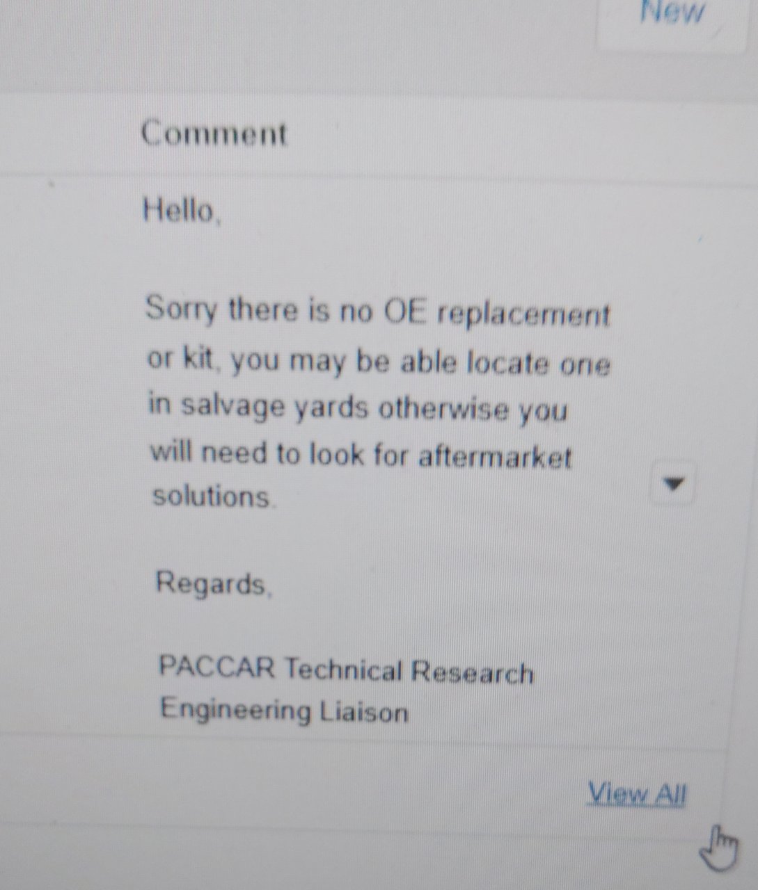

    So the radiator mounted k122-125 condenser was the other option instead of the grilldenser for those who bought these trucks? Or was it simply due to the 134 system was possibly the only option after 94 versus r12? I wonder why KW doesn't list these part numbers as alternatives since they discontinued the grilldenser.

  5. ProfessionalNoticer
    ProfessionalNoticer Road Train Member
    2,941
    7,858
    Apr 25, 2021
    There are no aftermarket solutions. Don't you love how they give absolutely zero support? They could easily do some research and let owners of these trucks know that one off a 1999 could fit with some effort and brackets.
