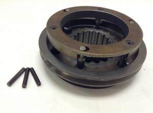

  9. DaveLV
    DaveLV Light Load Member
    182
    261
    Sep 18, 2015
    display.jpg that's a synchro. Located in the auxiliary section of the transmission on the main shaft

  10. 8thnote
    8thnote Road Train Member
    1,980
    3,687
    Aug 12, 2013
    Chattanooga, TN
    Is it only for shifting between low and high range? Does it synchronize the aux with the main trans? I'm obviously no mechanic and I'm curious. Thnx
