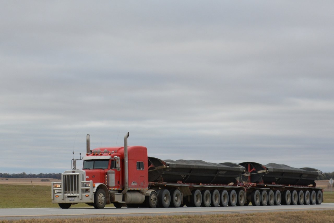

    Most of the trucks I saw in ND running out near Williston were tandem drive trucks with a pusher drop axle and quad axle trailers, either in a tight group or a tridem with a single axle spaced at 10-12 feet ahead or behind. Those could gross 105,500 lbs.
    Most 100k+ setups are state-specific and don't usually leave or travel on interstates. I remember seeing a pneumatic A-train setup out near Belle Fourche, SD; tri-drive tractor, tridem trailer, tridem converter, tridem trailer. 16 axle monster. Didn't have a chance to grab a pic though, still regret it.
    But then again, apparently SD really loves multi-axle setups:

    Lots of those rock trains here in SD, dont get stuck behind one of those in the river hills on highway 44. I have no idea what they're grossing with those things but it's got to be pushing 200k.

    Do enough Googling, and we can find the answer!
    Top 10 Heaviest Semi Truck Trailers in the United States and Canada
    171,000 lbs max.
    Something that kind of says a lot about the trucking industry in Canada, and the situation with poorly trained drivers operating equipment like the guy involved in the Humboldt crash: "B-Trains in Canada require no extra driver training or permit, unlike in the US where you have to have an extra driver training certificate to operate double trailers."
    Yet, in the rest of the places mentioned in the US, drivers require special permits to operate vehicles with higher gross combination weights.

    The 17 axle combo pictured with that article is old news. All the cool people have 20 axles now so gross should be closer to or at 200k.
