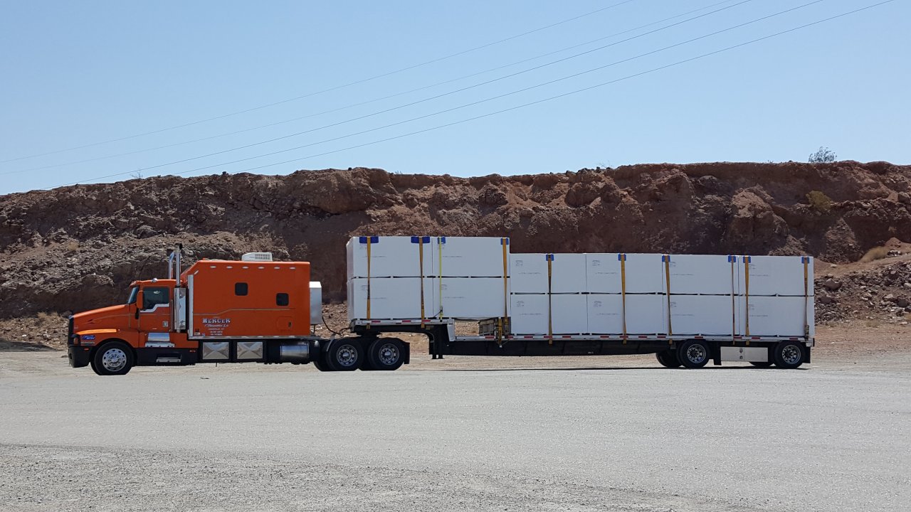

    There is always a lighter weight option....whole load weighs 10K

    Looks like roof insualtion....
