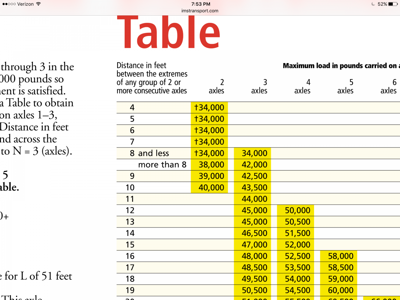

    The only differences I've seen that pertain to the Interstate only are allowed tolerances. MD for example allows 1000 lb on axles and grosses less than 80k off the Interstate.
    Referring to something like that, perhaps?
