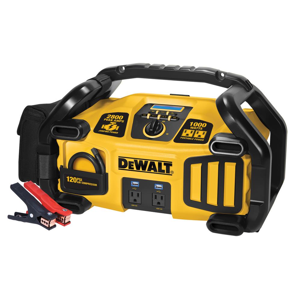

    I'm using a 15 Amp and 125-Volt extensin cord for my block heater & to charge my Dewalt Power Inverter.
    Is this an overkill?
    Electric conversions are not my strongest area...lol
