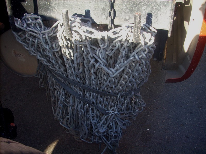

    I don't have pics of the process, but I do have of the finished product. My chain rack is on the right side of the truck. My two pairs of singles are hung on the front three hooks, two singles on the inside, one each on the other two, as described above.
    My rear three hooks have my "rails" or double chains on them. Haulhand already explained a very effective method of hanging rails, which is not the way I have them hung, so I will not confuse the issue with an explanation of how mine are done, although they are hung by the center lengthwise chain. His method actually sounds more efficient than mine and I would be very interested to see it and give it a try.
    It is difficult to get a decent angle of my front hooks because they are a bit close to a hot exhaust pipe and I can't fit behind the side fairing, but here you are.
