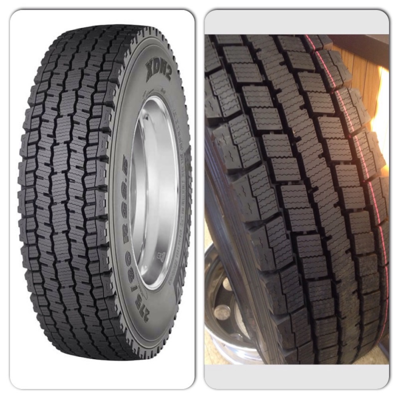

    Hankook has these new drive tires that are real close to the XDN2. They're $500 each if I buy 8 compared to $619 for the Michelins. Does anyone have experience with Hankook's? Can you get decent miles out of them? If I can keep my tire cost at .02-.03 per mile over the life of the tire I'm a happy camper. So I'd be shooting to get 200k out of these.

    The experiment begins. I stopped yesterday to get my truck serviced and ended up putting 8 of these on. We talked about them and he said they were willing to deal to get some out running and I'd be a good candidate since that's where I service my truck. So they bought my 8 drives that had 127k on them for $150 each and knocked the price down to $475 a tire including FET.
    They know me and know I watch my tires. If they develop irregular wear or I don't think I'm getting the miles out of them they will buy them back at a prorated price based on tread depth. I'll update here as I get some miles on them.

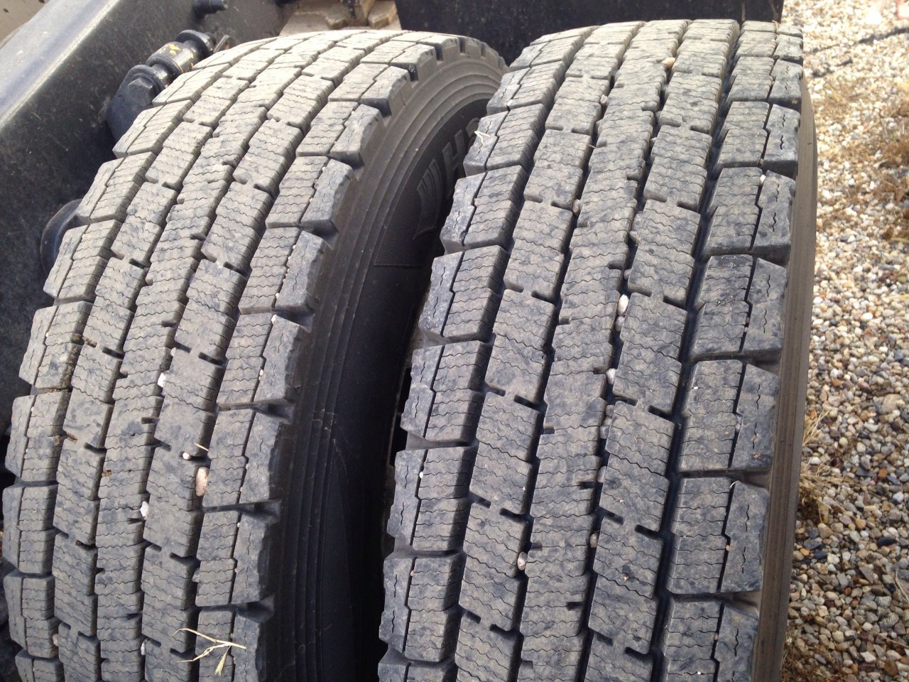

    As of today, 62146 miles on them. 22/32 of tread left on all of them. There are no signs of irregular wear and they were rotated in an X pattern with 22000 on them. So far so good. And they did take a while to settle down.
