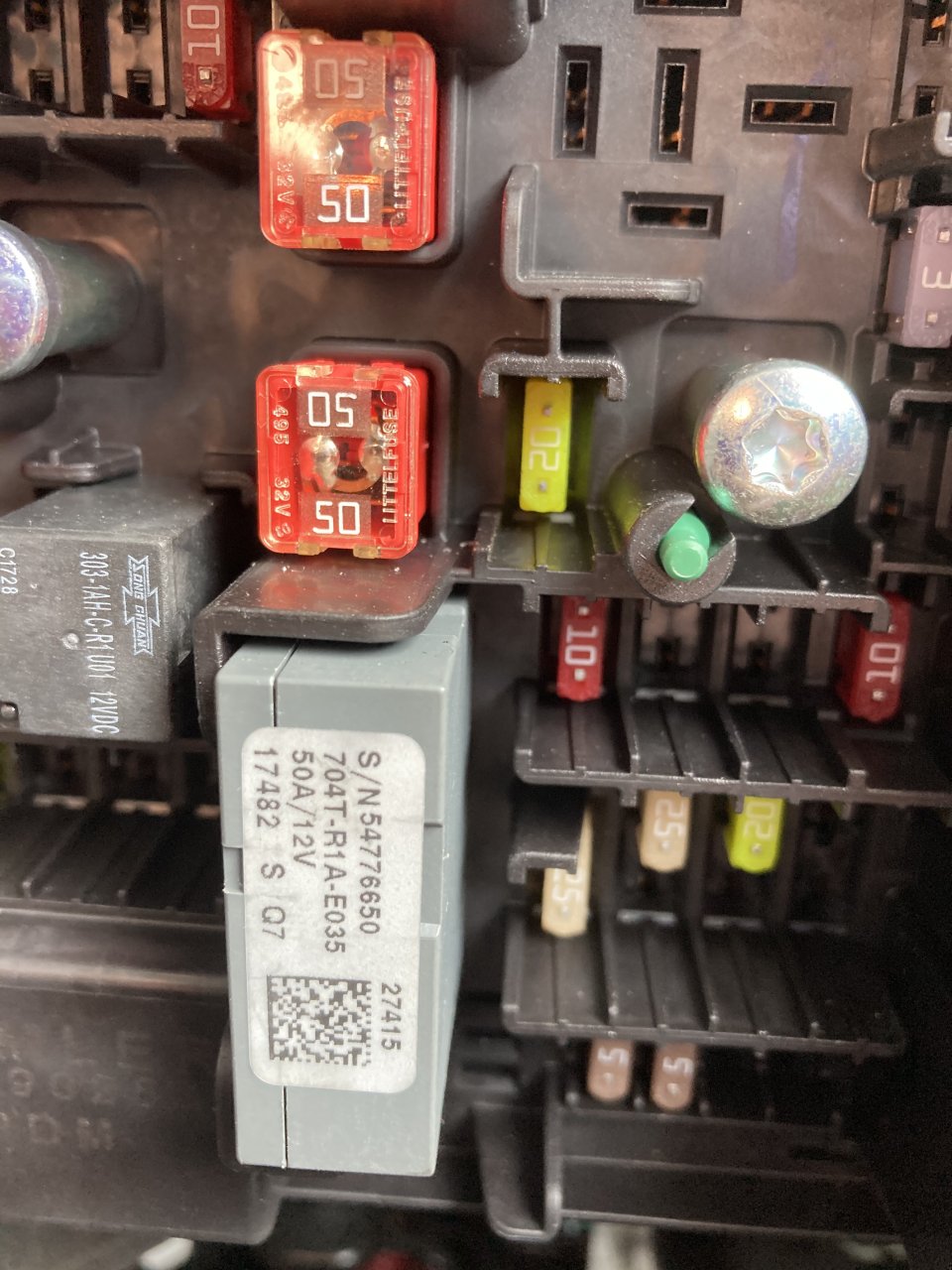

    I'm in a '19 Cascadia Refrigerator came with the truck. Unit stopped working all together and not sure if it's the unit or the power supply (fuse?). I know a lot of these are plugged into a 12v outlet but this one is hard wired. There are the typical red and black wires coming off the back and connect into a 2 prong plastic connector. The wires then travel back into a bundle of other wires and haven't been able to find access to trace them farther. I already asked Freightliner if they knew what fuse would control this, all they could tell me is one in the pannel at the passenger side dash. Any suggestions?

    In the fuse box. Fuse F20 it’s a 20amp right by the bolt in the middle

    The yellow one

    My fuse burned out too. It's in the same place on a 22 Cascadia. F20
