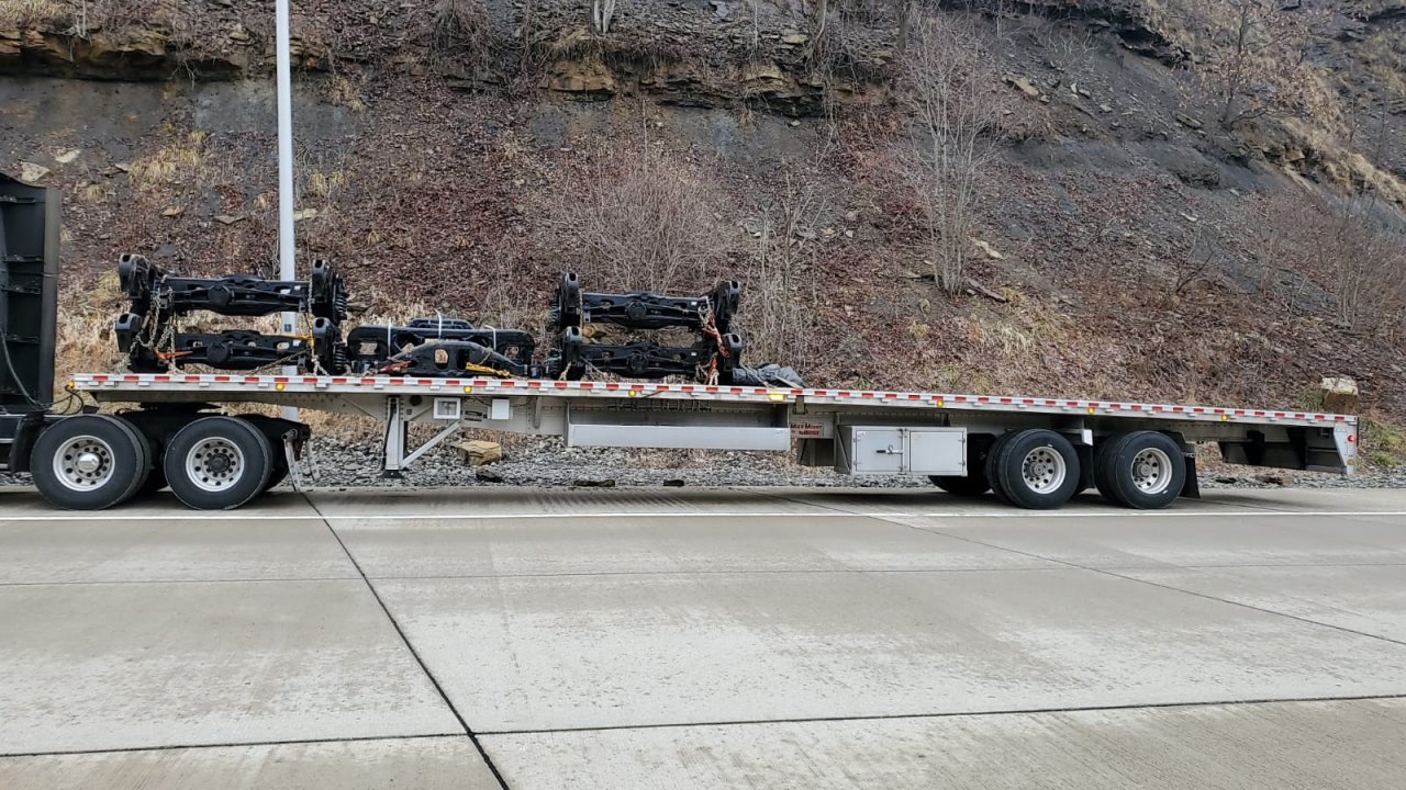

    Got a picture?

    The vast majority of our flatbed and step deck fleet (200 ish trailers) are 53’ sliding rear axle trailers. They look like a tandem when closed. We do have some regular sliding tandems but I don’t have a picture. 8F64120D-A4E9-4EFD-8AE1-21F3A82C9B7C.jpeg
