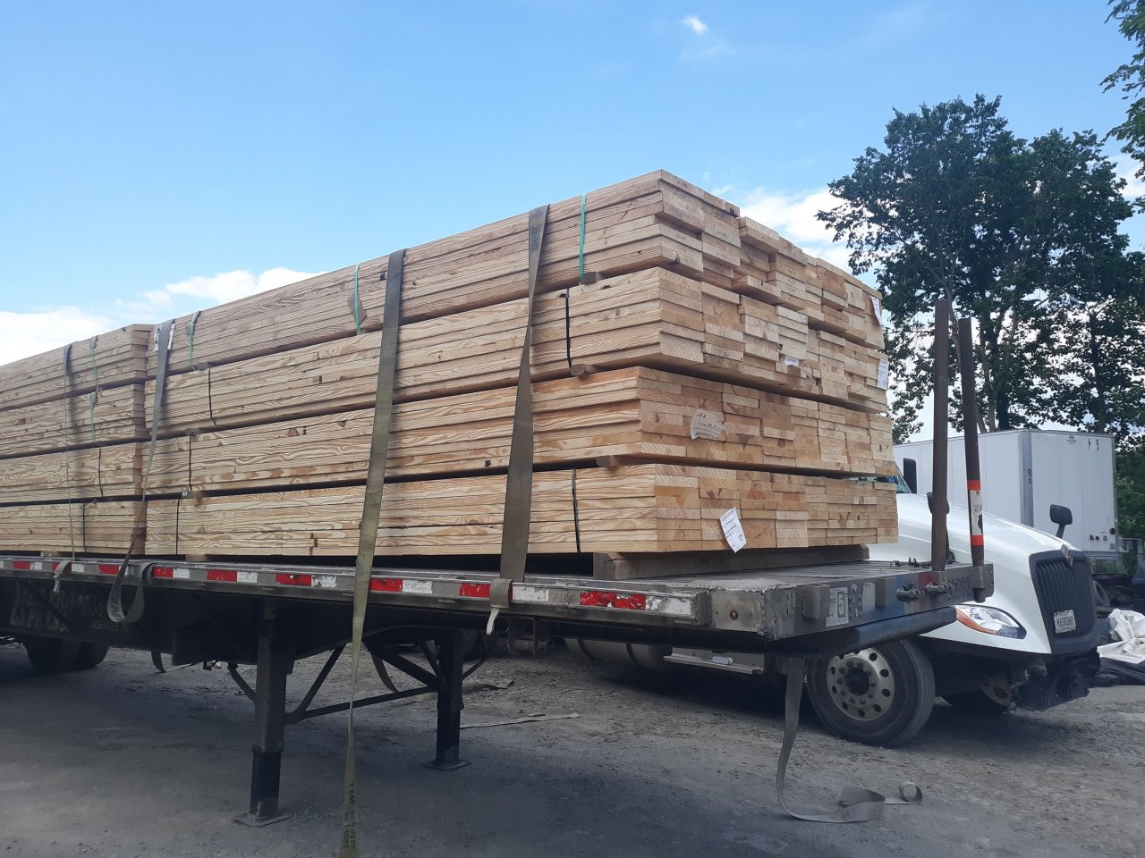

    I've seen it done pushing the hook up from the bottom with the hook facing out
    Also seen what you did but pull a little more strap loose from the bottom tip the hook forward and push it down behind the rail to catch it on the bottom of the rail. Like a triple wrap. But those bundles probably hang over the edge just enough that the hook wouldn't have room to slide down unless you turn them sideways.

    76
    Mar 14, 2020
    Yes the load hangs over just enough the hooks don't fit. But I will definitely try that on other loads.

    I had to recover a rolled load of lumber... Some bundles broke their strapping so you see green and black. I walk the top of loads and roll straps over as I go. Left, right, left, right. When I'm up there I look for crazy stuff loose or stuck in a valley I can't see from the ground.
    This load was on the trailer when I got there so the middle straps got pushed thru with a PVC 3/4" 8.5' long pipe with a T fitting on the end. Cut thru the flat long side of the T with a saw making a 1/4" slot. The end of a strap hook will wedge in that slot. Or a folded over strap. A chain hook can also be pushed thru something like the center of a spool by using the other end of the pipe. Best 5$ you'll spend.
    If the straps are hanging and you walk down each side sliding a winch to every end strap and hooking the other straps as you go then you will know if you need to readjust straps for lack of winches on a particular side or move straps to accommodate a weird part of the load.
    If you do that BEFORE you tuck into the winches you will be less angry LOL
