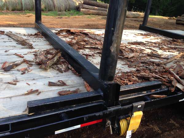

    Something you need to remember about loading a step is you are already 8 or 9 feet behind the kingpin. When I load pipe I usually load right against the neck and sometimes once I get above the step I slide a couple tiers forward to get a little more weight on the front. I build bunks that I chain to the deck instead of channel stakes it works pretty good, if I get by the yard today I'll take a picture of them. Most tubing is pyramid loaded just because stripped tiers gets pretty high but if you pyramid two layers and then strip you should be ok, I would think you should be able get thirty five joints across the bottom if they have collars more like forty without.

    Thanks. Yes I was thinking of building some bunks like this.

    Those are basically how mine are built. As far as balancing loads, you have to remember that the distance from the kingpin to the center of the suspension is what you are working with so with being already 8 or 9 feet behind the kingpin your already moving weight back. This is the reason when loading a long piece on a step that has a heavy end you always put that end against the neck otherwise you get terribly tail heavy.
