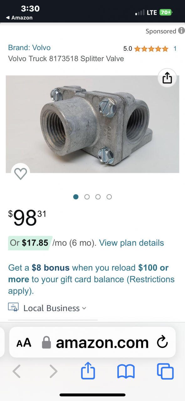

    Maybe the return isn’t going into one tank. It’s not sending fuel to the other. Just not getting replenished and running out early. Shut it off, it equalizes because it’s a closed siphon system. Same problem on my Freightliner. Haven’t fixed it yet myself. So I don’t know, just guessing. They have a fitting called GT splitter. Don’t know if Volvo’s have one. It equalizes return rate to tanks. Splits return from engine into 2 lines. They can go bad and cause only one tank to return.
  11. Rideandrepair
    17,578
    56,942
    Aug 8, 2015
    ED88E78F-D67F-43A2-8DA9-557D9C4CE54B.png Amazon. Best call Dealer, get proper part per vin #
