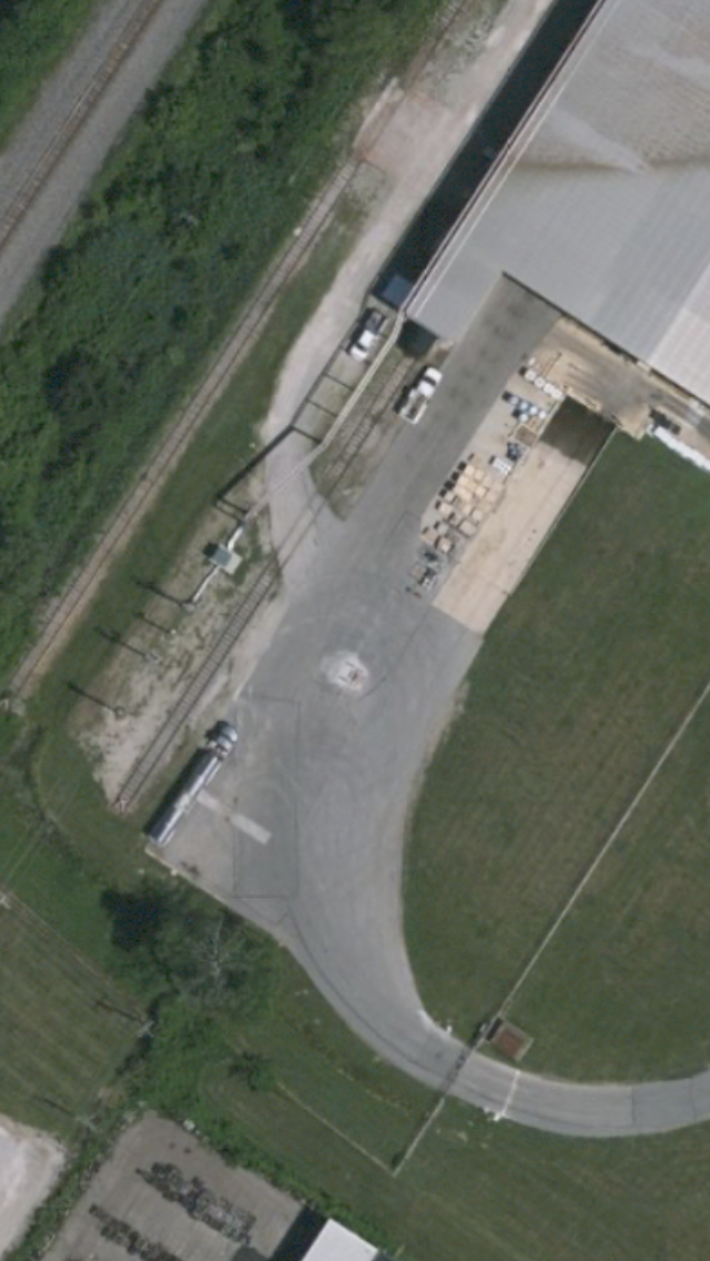

    C887C6F0-4E3F-4690-AAF3-2F3B71A6A42C.png Here’s the dock. There’s a fire hydrant in the middle of the Lot. Not enough room for me to u turn around it.They also had 4 Trailers dropped in the corner. My Trucks 285” w.b. Classic. I made a U turn between the fire hydrant and had to get on the grass a bit. Clipped the Tankers fender. The Plant Manager came out and asked my opinion on where a new gate would be best. A Gate near the dock, with gravel or pavement instead of grass was my suggestion. Apparently they’ve had a lot of incidents.
