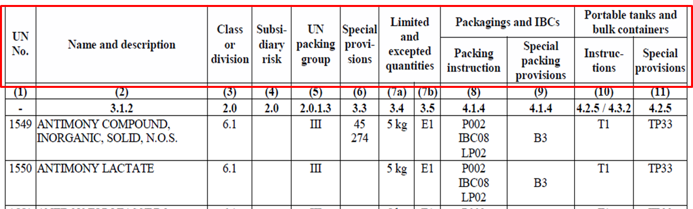

    Selected dangerous goods packed in small quantities (limited quantity) or very small volumes (excepted quantity) pose a lesser risk in transport than do the same goods packed in larger volumes. Thus they qualify for some relief from robust packaging requirements provided that they are packed and marked properly. This could save considerable packaging costs.
    Definition of Limited Quantity and Excepted Quantity and How to Find Them
    The limited quantity is the maximum quantity per inner packaging or article for transporting dangerous goods as limited quantities. It can be found in the column 7a of Dangerous Goods List. In the example below, the limited quantity for antimony compounds is 5kg per inner packaging.
    Limited quantity in domestic transportation, no HM description, no placards and no HM driver required
